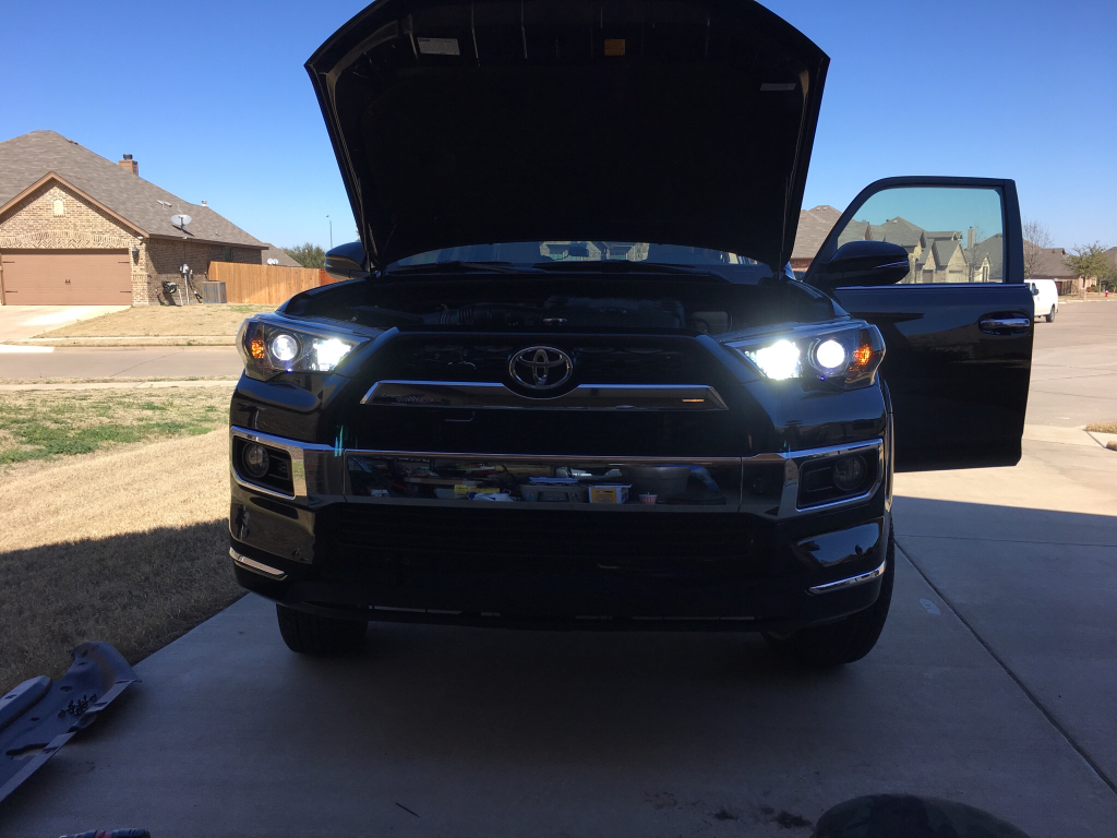

Just completed this DDM mod- mostly for the LED DRL, but the brights are awesome, especially when some clueless driver starts to pull in front of me at the last minute- light em up. The install was a cinch. Not sure if it was mentioned earlier, but it might be worth trying the O-rings that were on the original bulbs. I had the same issue with the black O-rings being too tight and orange too loose, and just loosened the cover until it fit. Anyway, awesome, inexpensive mod. Lots of looks from other T4R drivers. Oh right- I was one about a month ago.

Installed these and Xenon Depot 5000k HIDs. I bought my DDM DRLs on Amazon and received them in no time with prime!
Mine also have the hyper flash but I don't mind them at all. Like many others have posted, these are super bright!
