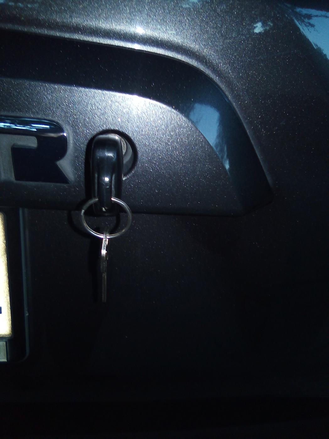

Was pretty sure I had noticed a key slot in the tailgate of my wife's 2014 SR5.
As it turns out, I did. Check out the photo.
Perhaps later models did not include them, but this is a 5th Gen forum and the 2014 is part of that Gen.

I don’t think that key slot allows you to unlock the tailgate. I think it’s just for operating the window. Even if I’m wrong, you still need battery power if there’s no mechanical link to the tailgate latch.

That may be the case with the Limited.
Mine is an SR5 - key unlocks tailgate.
The latch for the tailgate is still electronic. Turning the key in the tailgate is the same as pressing the unlock button on the driver's door. An added bonus is that it lowers/raises your back window. If your battery is dead you will still have a locked tailgate.

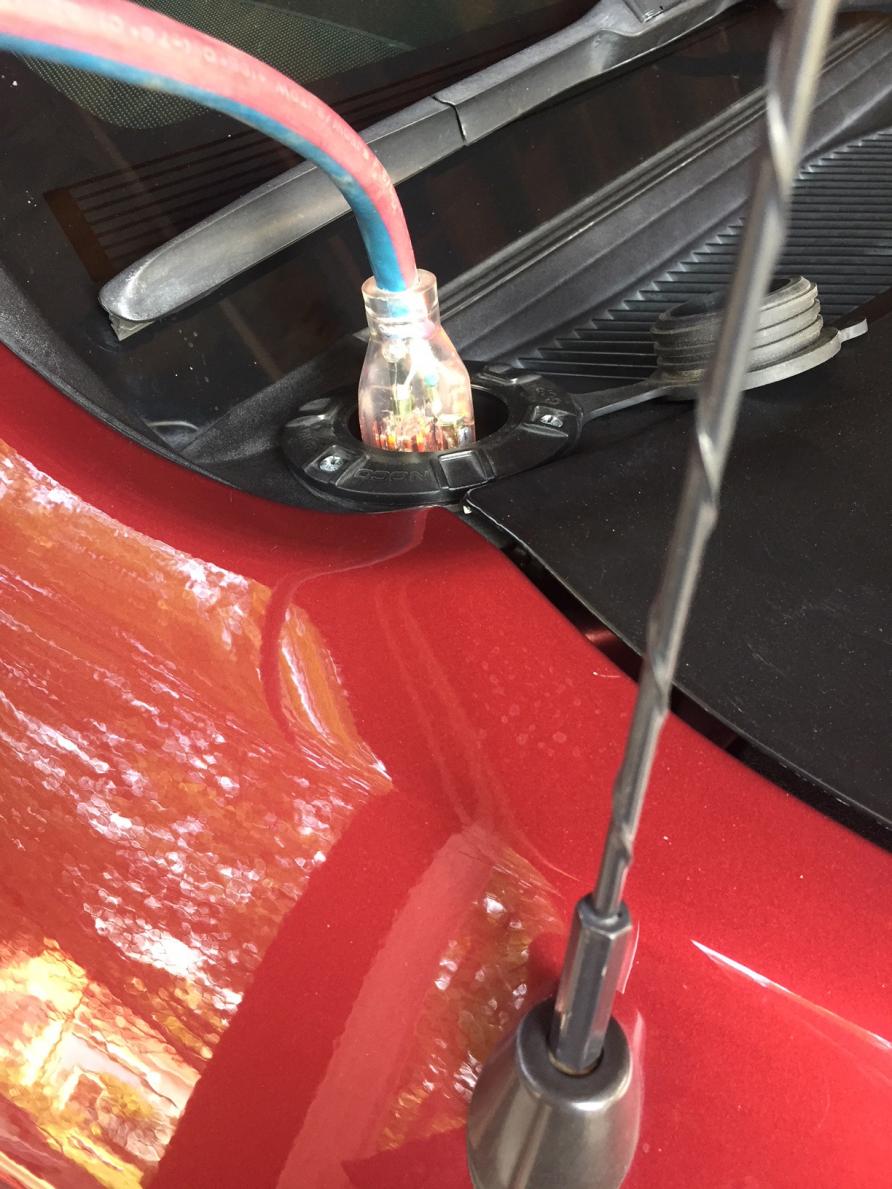

to unlock the doors basically any kind of connection to the battery will do it, you don't need a lot of power for a door latch
Me personally I have solar connections and 120V onboard charger connections I could use, but hell a 12V cigarette lighter port wired in the engine bay you could get to from under the vehicle would probably work just fine.
I have an on-board charger/maintainer and the plug is accessible with opening the hood, cheap and reliable add-on, cost me $120 and an hours time.
