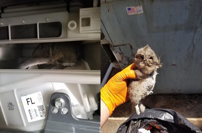

So found my pictures! This is the single biggest animal I have pulled out of a vehicle so far (unless you count the two 2~3ft snakes I pulled from a Prius), about 9-10inches long from head to toe. He was dead a while and good lord did he smell, after this job I just bought a respirator and use it on all rodent jobs. Couldn't be in the car for more than 3 seconds without my body reflexively gagging at the stench. Rigamortis had set in so I was lucky to pull the blower motor out and gently coax his corpse out without him popping (I swear with how rancid that guy smelled I would not have been surprised if he was filled with maggots). I had never actually seen a pack rat before this, so I almost assumed the family had lost their pet chinchilla in the car and it died. Poor guy got into the blower housing but he couldn't get back out and died there, it was probably the cleaner of the rodent deaths I have had to clean.

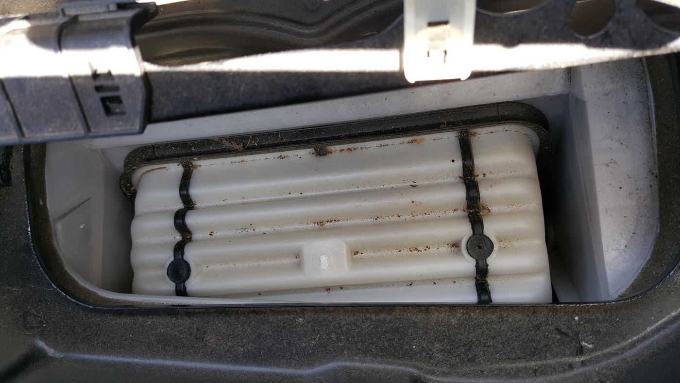

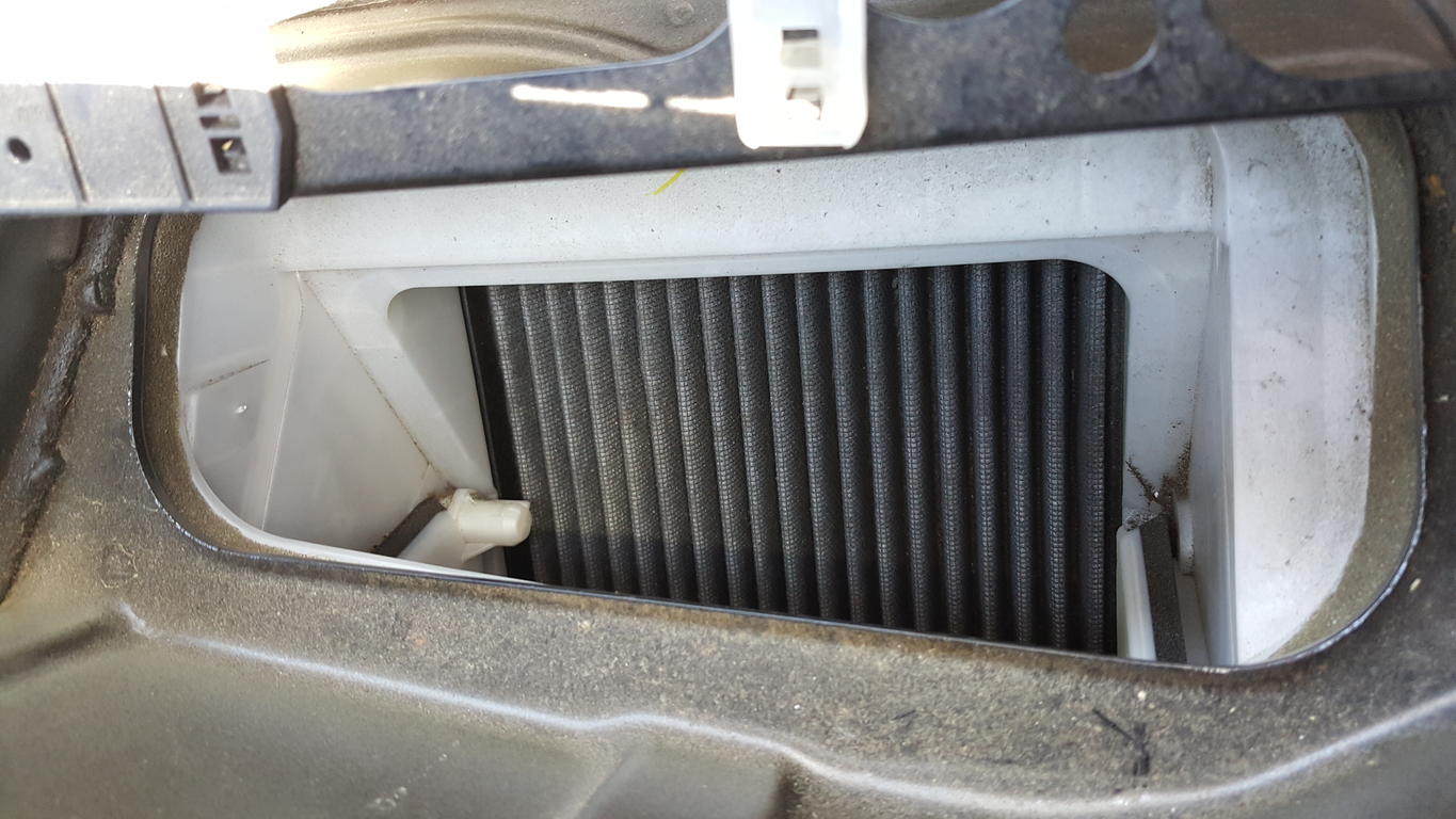

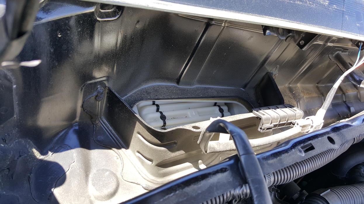

Took cowl off and did not see anything unusual.
The recirculating air cover did not show signs of
tampering. It looks like there was no entry through
the cabin filter area. Ran the blower motor on high
with heat on while hood was opened and cowl off.
Ran it for about 15mins with recirculating vent off
then on. Odor seems to have diminished somewhat.
Looked around fenders and anywhere I could
check under the hood. Didn't see or smell anything.
Put everything back and kept windows lowered.
Next step will be to remove rear cargo mat and
look around that area. I'll update when I get it done.
FWIW, the raised opening to cabin filter is approx. 11.5" long
and approx. 4.25" at widest point.
