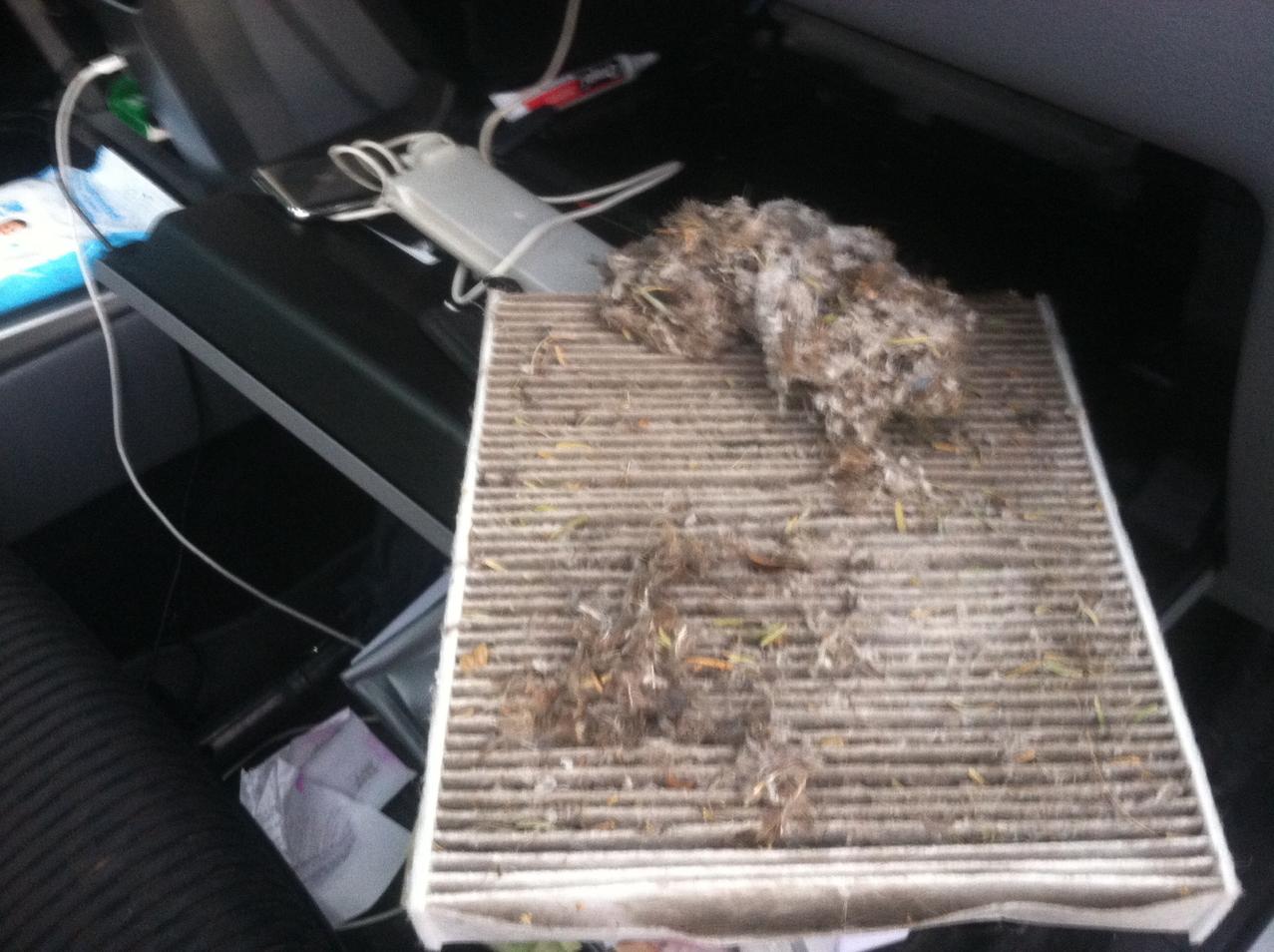

This was my cabin filter the other night. I don't think it was new or from my area.....I think it was from a one night stand(the mouse) in Colorado this past summer, no poop or evidence of babies, but I did find bright green moss in the nest, we don't have that in abundance here. That's why I'm hoping it was a one night thing, but that lil guy must have had one good party!

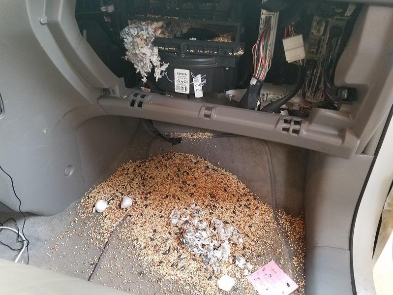

I got ya beat... Customer stated they thought they smelled something and the blower wasn't working well.
I found where all the missing bird seed in their garage went... all about 5 pounds of it. Thing was filled to the top.
Took 3 more dumps after this picture to finally clean it out.
