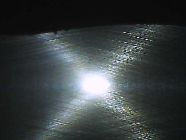

Just heard back from the dealer. It was a cut oring that showed up to us on the 2nd day after the oil change. They scoped the cylinders (photo attached) and all looks fine. They hand washed all the skid plates and under carriage and will be dropping the truck off at our house. I had them record all of this in our record and in the national database and to Toyota. I also have copies. Plus $100 credit. I am happy they made it right (for now).
If it was starved for oil at any time, the rod and main bearings would show excess wear, first. The last place I would look for excess wear in a (possibly) oil starved engine, would be the bore finish.
Of course to inspect rod and main bearings, is much more involved than pulling a sparkplug.
As long as there is documentation that the engine may have been run without sufficient oil pressure, you should be covered in the event of any bearing problems showing up in the future.
Of course if the oil light never illuminated while the engine was running, the engine should be okay.
