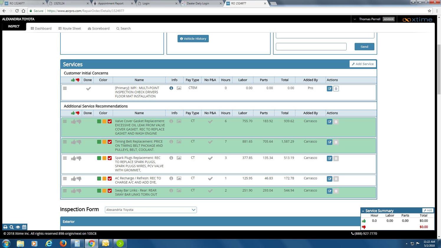

So I brought my 2001 limited to Jack Taylor's Toyota of Alexandria, VA (DC area). I bought the truck about 8 months ago and have done oil/fuel filter/oil filter change already. As it didn't have a service history, I wanted a thorough check by the mech. He recommended the following, which seems astronomical
Valve Cover Gasket Replacement & Engine Wash- $939 (6 hrs labor)
Timing Belt Package (pulleys, belt, & coolant)- $1,587 (7 hrs labor)
Spark plugs, wires, PCV replacement- $513 (3 hrs labor)
A/C Recharge- $172 (1 hr labor)
Rear Sway Bar Link replacement- $544 (2 hrs labor)
This all seems quite ridiculous. Correct me if I'm wrong, but you need to take off the upper and lower plenum and valve cover to do the timing belt job, so it shouldnt take 7 hours to replace the gasket while you're in there. Similarly, the spark plugs, wires, and PCV are readily accessible while doing the valve cover gasket job and shouldnt take anywhere near 3 hrs. I am not a super savvy wrencher but I"m inclined to believe I can do the rear sway bar links easily myself.
Can I get a sanity check on this stuff and if anyone has a reliable local shop in the DC area that would be better to get this all done at, I'm all ears. Thanks!!

The plenum doesn't have to be removed for a timing belt change. It isn't that
hard to DIY; the main speedbump is r&r of the crank pulley. Lots of pictures
here on how to do it.
Plugs, wires, and PCV can be done on their own- nothing else needs to be
removed. $200 TOPS in parts, and hour of your time.
Valve cover gaskets and engine wash for a grand? Hard to overstate how
bad a rip that is.
a/c? $50 Harbor Freight gauge kit and two cans of R134a for $40. Their price
might be worth it for the aggravation factor.
I'm in Richmond, so I don't know your area. I'd seriously consider what it would
take to get tools and a place to do some of this DIY.

O U C H! I did all of that (minus the sway bar and AC recharge) last year for around $600 or so in parts. None of it is really very difficult. If you can find a buddy that wrenches to help you, even if you kick them a couple hundred bucks or lots of beers, you'd be WAY better off.
I'm not sure what their hourly rate is, but yes that is way too much. The dealership I work at would be far less.....$1000+ less for all of it.
$1500 seems pretty damn high to me for a TB job. The full TB kit from a reputable source costs MAYBE $350 max, and with 7 hrs of labor, that's over $164/hour. Most dealers are in the $100/hour range.
Add OEM coolant at like $32 a gallon, and you're still not close.
(Also, I guess I'm amazing. I did my TB with my dad a few months ago for the first time, and it took 8 hours, with a lot of breaks, and a couple trips to the store)
FWIW, Firestone says that the TB/WP job on the 3.4l V6 is only a 4 hour job. Seems the dealer would be better/faster at this, seeing as they are Toyota 'experts'.
Same thing with the Valve Cover Gasket job. Their hourly seems WAY too high.
You don't need to touch the air intake (air box, plenums, etc) at all when doing the TB, actually.
And you will want (but not NEED) to loosen the plastic TB cover and let it hang around the radiator to allow easier access to the fronts of the valve covers, though.
Either job will open up more work area and make the other job EASIER, sure, but they don't rely on each other at all.
Spark plugs should NOT take 3 hours, especially for a dealer. I can (and have, during my lunch break at work) change all 6 of mine, start to finish + cleanup, in an hour.
And yes, if you're already down to the valve covers, you can easily change the spark plugs while you're there. So that would add MAYBE 10 minutes to a valve cover gasket job.
The proper NGK/Denso Spark plugs cost like $25 total, Spark Plug Wires cost like $32 total, and I think an OEM PCV ran me $12.
This dealer is trying to screw you.
