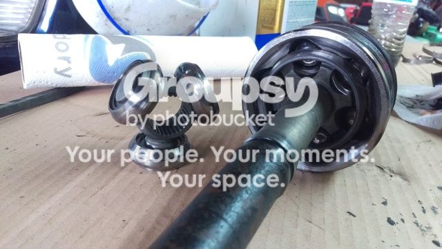

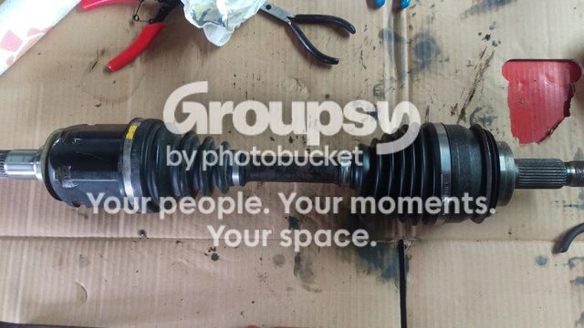

I finally replaced my axles, left and right from Rockauto. it's the Cardone unit. while i'm in there, I also replaced the front differential seal. the unit is actually not bad. my old OEM one started to have some groove where the oil seal is riding and I think, that's not good. All in all, my old one is still good except that groove is an alarm which might cause a leak at some point.
