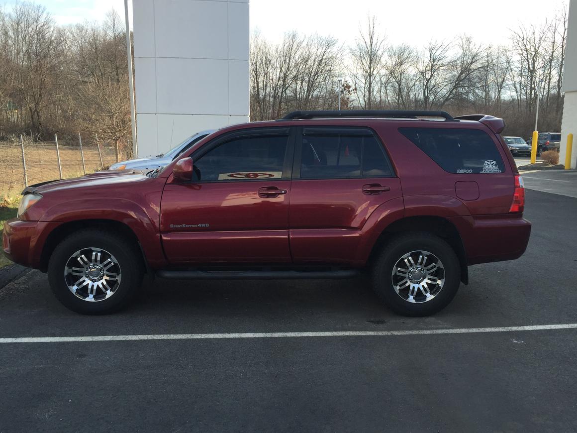

So this is it! Not in love with the wheels but those will be changed. Not a huge fan of red either but it's in great shape! What do you all think?
I think it looks great. I love the red - unfortunately I never was able to find one that color that met my other criteria.
Does it have a slight lift in the front? Looks about 1" higher than mine.
Enjoy!

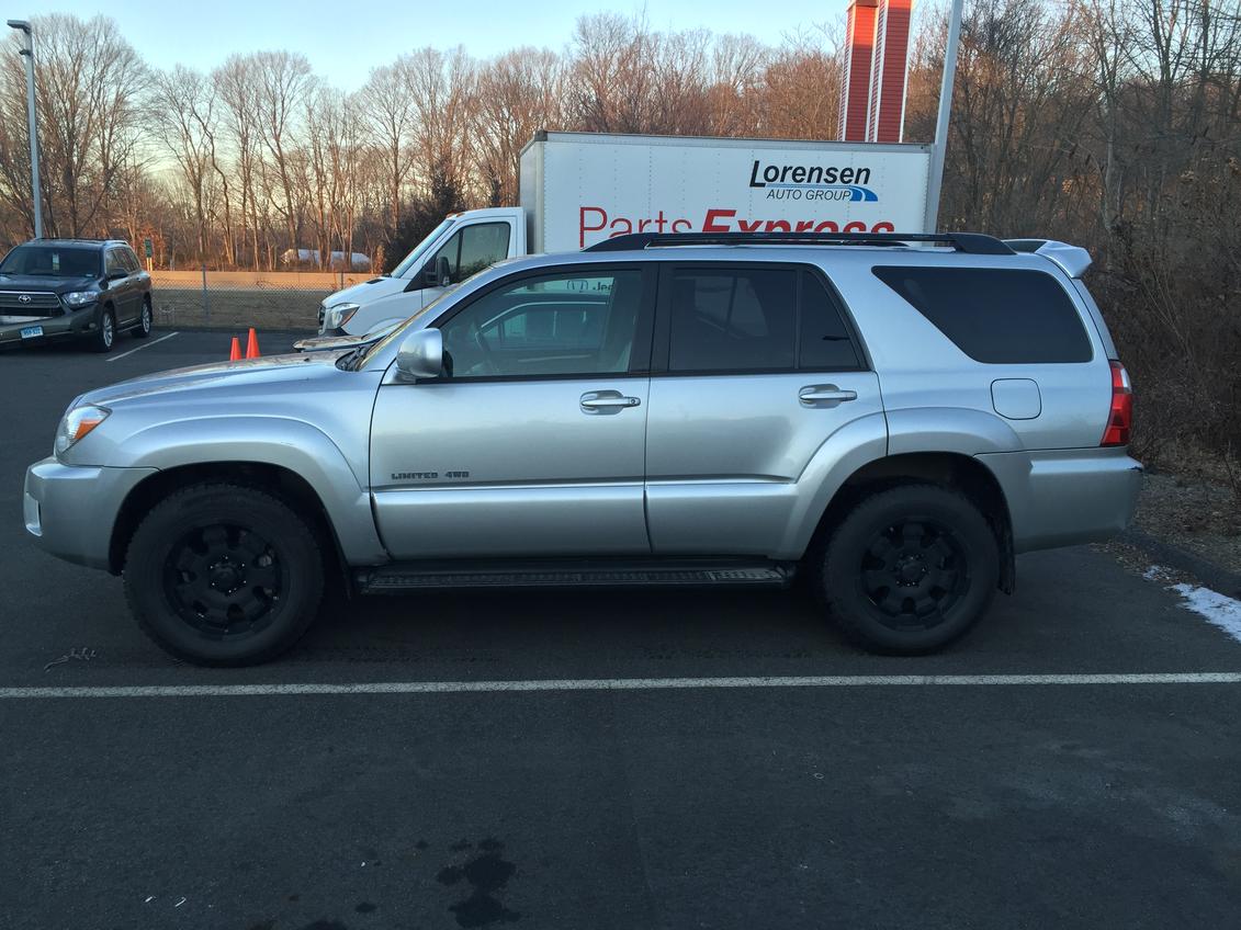

Thanks guys! The dealership just took in a 2008 silver limited v6 with 69k miles. I can get it for $16k. It's in great shape also. Ugh now I have a decision to make. Double the price. Is it worth it?!
