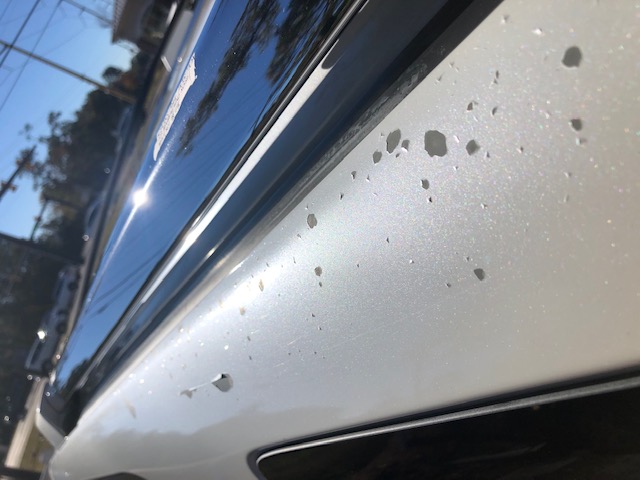

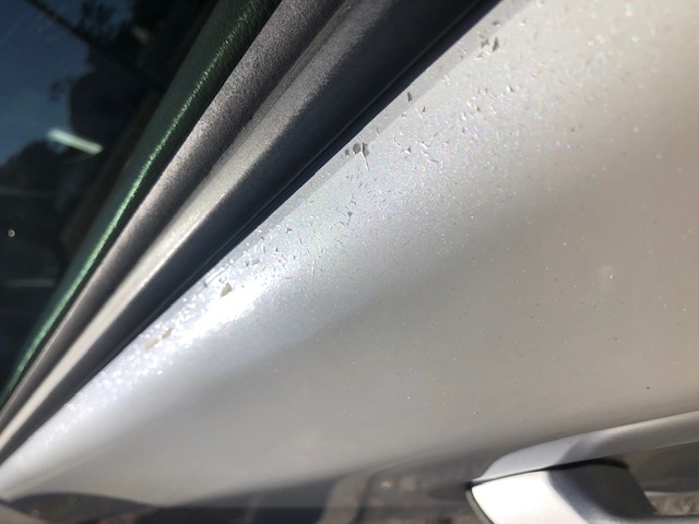

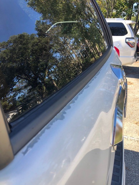

A few photos, 2011 wtih 150,000 miles. Most of this has happened in the past several months, it started below the rear hatch window.

Nothing like low VOC environmentally friendly garbage paint and non chrome conversion coatings. Bring back high VOC with chrome sealers and this shit wont happen again.
Having rapid delamination in such a short time is indication of complete paint failure. Shocking the amount of delamination in the picture.
