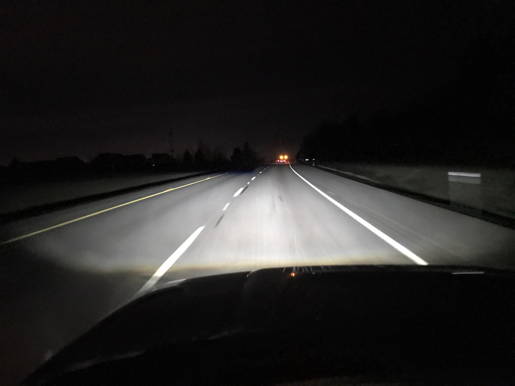

LED's can't touch halogens yet. Guys will argue that, but that's cause they spent $300 on the PIAA LED's- or whatever they cost. The color is nice, but the output still just isn't great yet.
Of course, retrofits are nice too-
That's my low beams.
