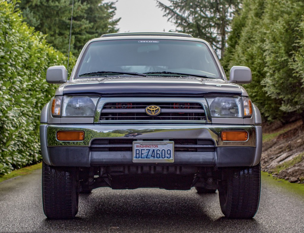

If you don't want to spend a bunch of money or do any modifying, I'd consider getting the 99+ style headlight housings with the clear glass and some good bulbs.
Thanks, that's a good suggestion. Many years ago I took some tacoma headlights apart and painted them black before the HID mod had been done. I don't see myself playing too much with this truck other than maybe biggest tire that will fit on stock suspension and comfort things like bulbs light bars etc.
My '97 has the clear lenses but unless they were changed by a PO they're original. Did Canadian vehicles get the other style sooner?
No idea, I'd guess they were replaced at some point.
Here is a picture of what I was talking about:
98 Headlight:
99+ Headlight: (stolen off google, nice truck to whoever owns it on here!)
