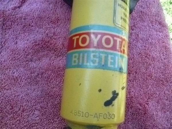

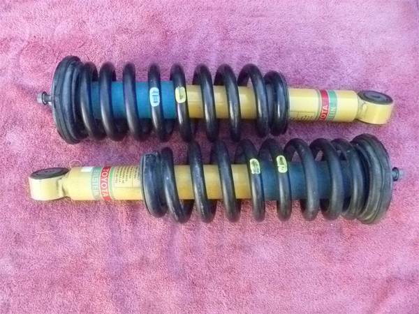

Will they fit a 4runner? I was looking at them online tonight? Please let me know.Is this the example you were talking about not to buy? They came off a 4x4 TRD Trundra.

If the link provided are the ones the OP was talking about, then he does not need them. Those are not 5100s, and are not adjustable. The coils are not the same that everyone uses for a lift.
If however you do find a set of y/y y/b coils with the stock shocks, they're worth around $100 by now. These are getting old and even if they were taken off with low miles, they've been sitting around and the shocks will start to degrade.
Thanks for the information! I was a little concerned about the paint markings on the coils, they just didn't look right. Plus the seller has been dragging his feet on a time/day to meet so I could see them. I will most definitely pass on them. Thanks again.
