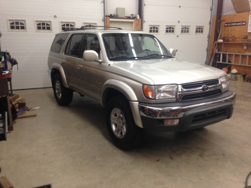

Decided to go with Toytec Ultimate lift. Tires will be BFG KM2 255/80R17's on black Level 8 MK6 wheels with the factory silver TRD centers. Here is the rig its going on. 2002 SR5 186k. Anybody want to change my mind? Sway me in another direction?

That's pretty much it. I have a 2008 Tundra also so it really won't be driven every day either. I prob won't off road it a lot but when I do I want it to be able. I'm use to the buggy in my avatar so I will have to be careful and before the buggy I had a built 85 yota on 35's with front and rear lockers. Main decision is to go with the 255 (33's) or stay a little smaller with the 265/75's? I used the excuse for buying it to have something to haul my new Weimaraner pup around in (keep her out of my Tundra) but I really just wanted a 3rd gen to lift.

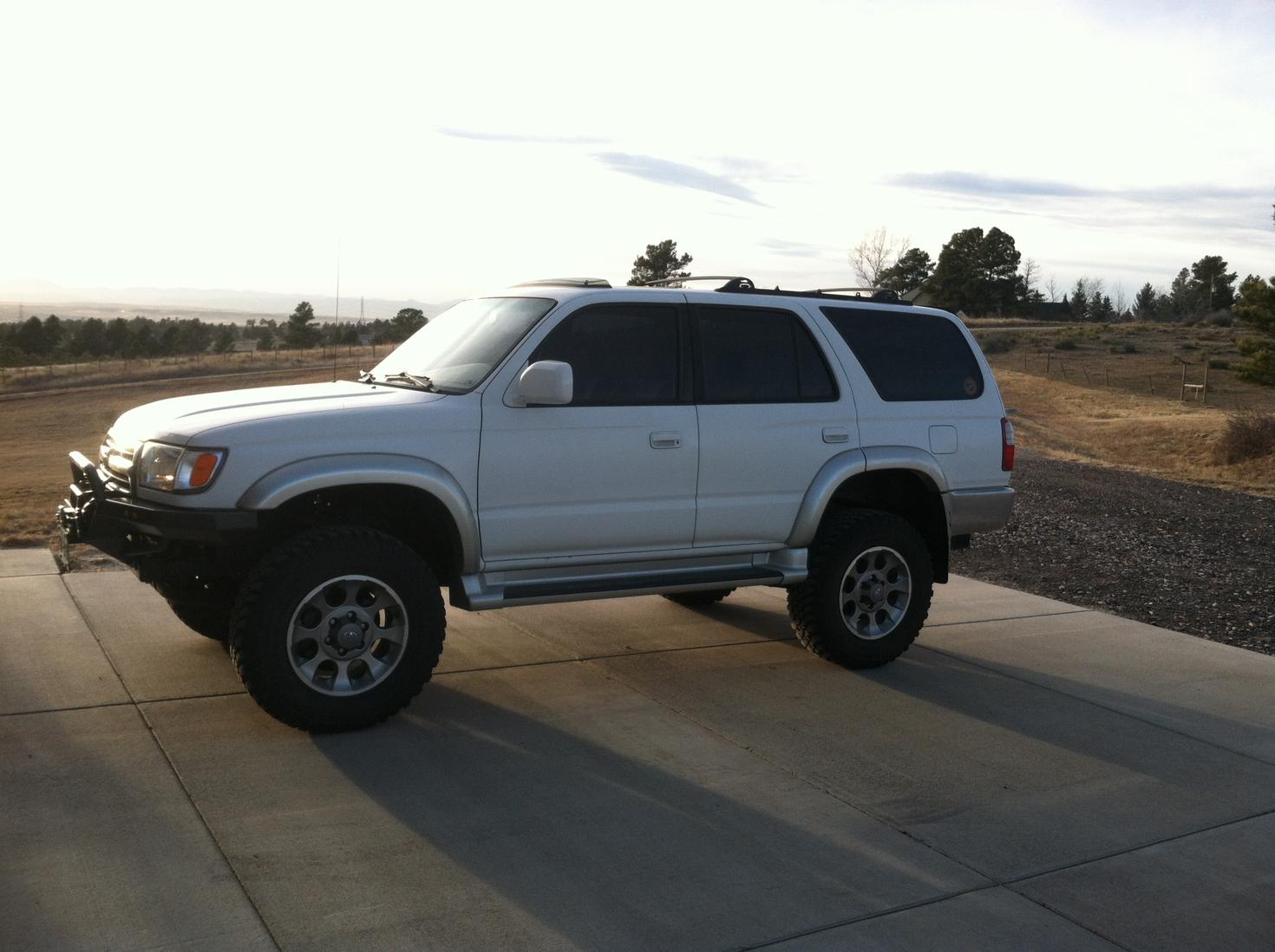

I run 255/75s with about 3.5" of suspension and 1" of body lift. I like them quite a bit and am more interested in how a tire performs rather than a "look" that nobody else really cares about.

I posted a picture, can you not see it?
