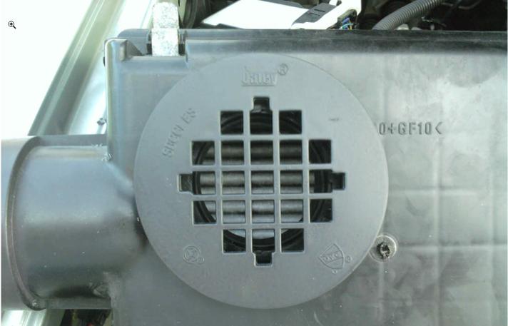

That's pretty cool. What size is that?
It doesn't look that big.
It's only a 2" so it's not really all that big. I wanted to go that route first simply because of how well it will seal. I like it so far and if I want to open it up even more there's plenty of room to add another one. The best part to me is the front 'grated' plate could be interchanged with a flat plat so it could go back to completely sealed in seconds.
