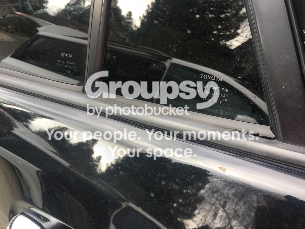

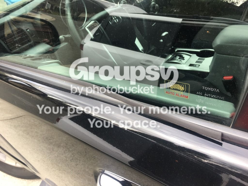

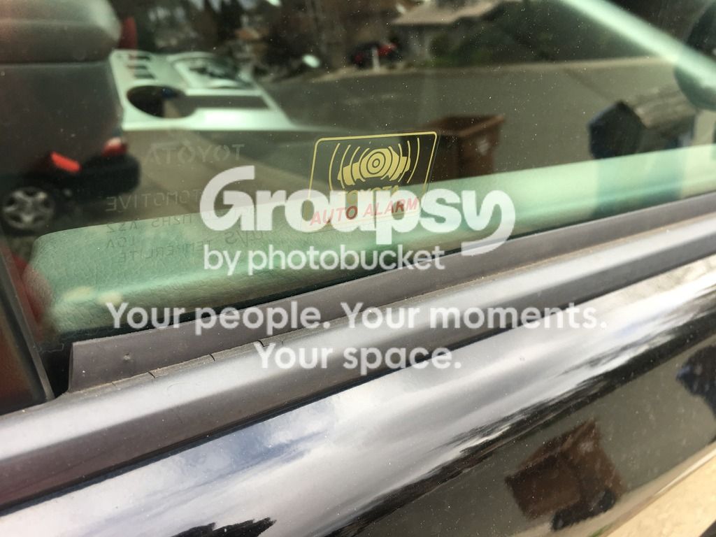

Has anyone had they exterior door window rubber damaged due to age? It's called the "Belt Molding" on the parts sites. I had thought one had been damaged from a break in attempt in 2015 and replaced it, now I noticed that the 3 I did not replace are all damaged. My 4Runner is a 2011 and I've owned since new and I live in the SF Bay Area in California so it is in a relatively mild climate.

Looks like the rubber just rotted out... kinda common. A bunch of us replaced the belt moulding.
I've got part numbers in my thread.

So I’m not the only one then, I couldn’t find any other posts about it. It’s way too soon, I’ve had cars 20-30 years old that are fine.

Correct you're not the only one. I agree I've seen a lot of older cars that never had belt moulding/window seal issues. Order the new ones and pop them in; for some reason the early 5th gens had crappy rubber :/
My 2010 SR5’s window rubber has disintegrated on all 5 openable windows. That is one of the only disappointments I’ve had with my truck; well that and the fact that I couldn’t get a small turbo-diesel...

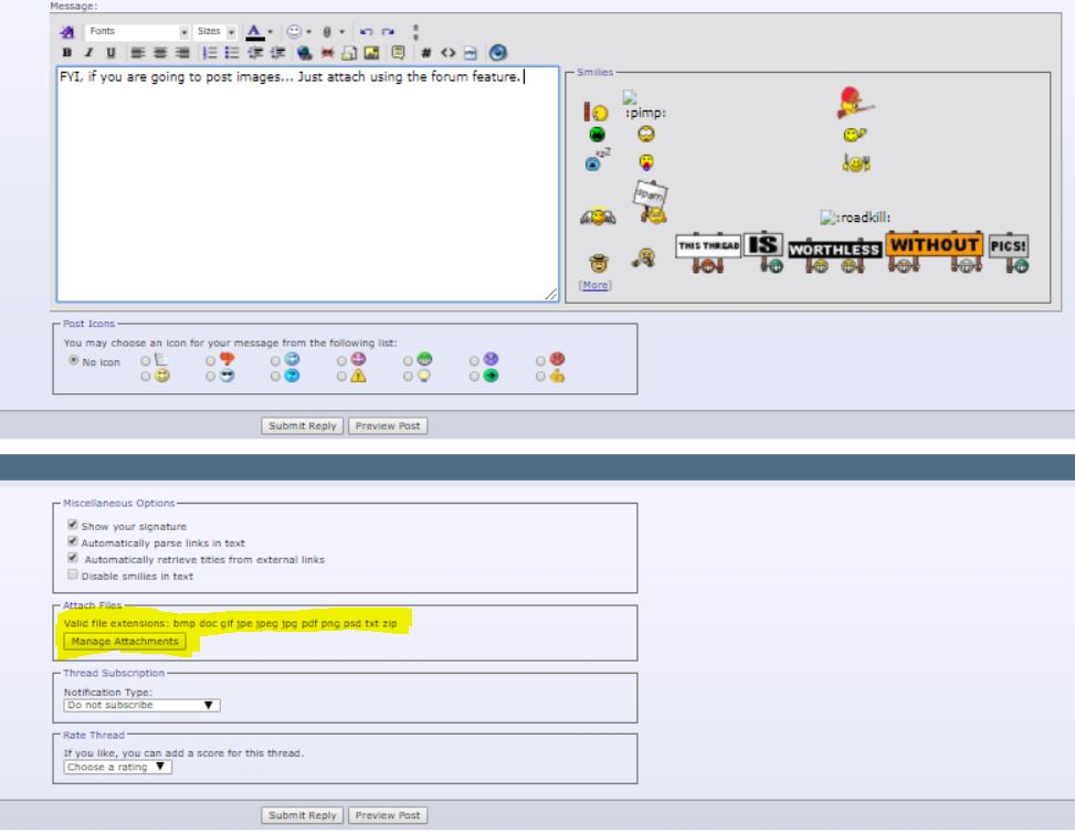

FYI, if you are going to post images... Just attach using the forum feature.

I guess I'll just have to bit the bullet and buy new ones, I guess only time will tell if they revised the compound to prevent this from happening again
