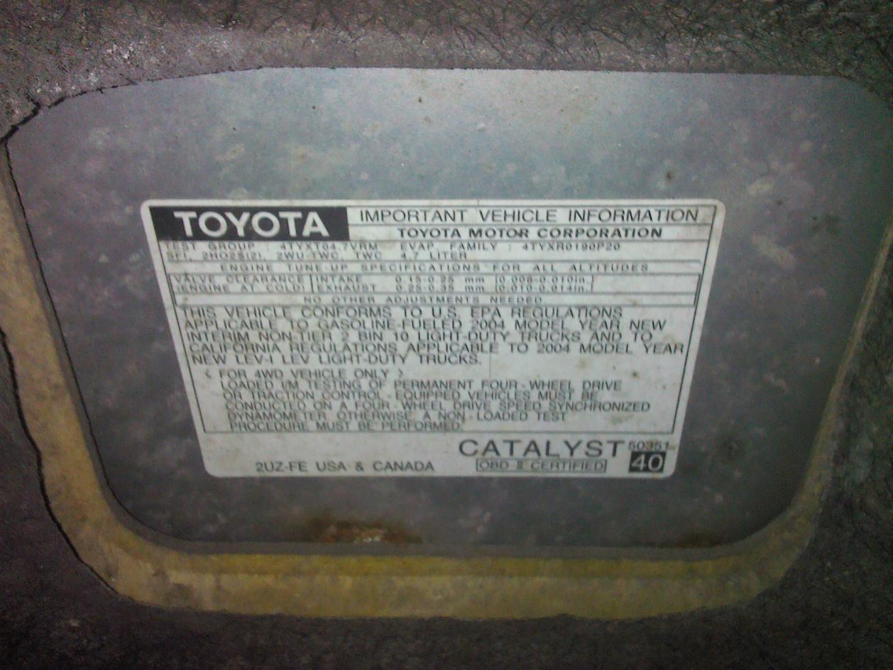

Does your sticker under the hood say "meets California Emissions standards" or something similar? If not, its most likely federal. As for the body code; I am not entirely sure, that may be a differentiation between say Limited and Sport/SR5 as some Toyota literature references there being a minor difference.

Couldn't wait...here's the sticker

I still have the code for Bank 1, Sensor 1 and an exhaust leak on the same (driver side).
Anyone have input on this O2 vs AFR conundrum? I see the V6 has AFR for 04, so maybe that is the source of the confusion?
