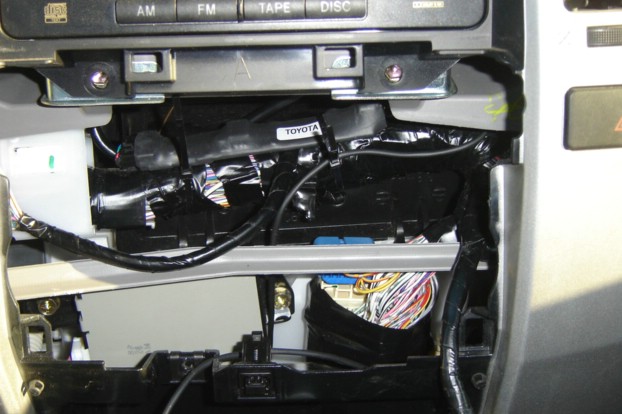

I zip tied mine to the bunch of wires and ran the dock cable into the storge bin below the AC controls. The bin is too small for anything else any ways.
Ahh fantastic, that is exactly what I thought about doing. I take it the IPOD fits in that cubby hole with that ongodly ugly dension cradle?
Can you take a pic of it in the cubby hole?
I have the ipod in the glove box to keep it hidden from view.
There was just enough cable to put the icelink adapter itself tucked behind the glove box. That gives me easier access to it in case I need to uplug it or the docking cable.

Dension offers two differant ways to connect the ipod a cradle and just a plain dock cable. For a hidden install get the dock cable. I will try and get a picture posted of the cubby hole later.
I'm so excited! I have a 2005 4Runner Sport Edition with the JBL 10 speaker, single disc stereo. From what I'm reading, the Dension product will work with this, including text display and steering control. Two things I'm concerned with: mounting and if i can do this myself. I love my 4Runner and cars, but I never work on cars. Is this something I can do? If so, can someone kinda help me with it? I'd also love to see some pics of mounting. I also went to bestbuy.com and only saw this product for bmw, honda and volkswagon. Any reason?
I've got my Ipod stashed away in the center console. This does require drilling a little hole to get the adapter wire through...but very easy to do. I decided to go with the center console instead of the glove box because it's easier for me to reach in case I need to access the Ipod for any reason.
