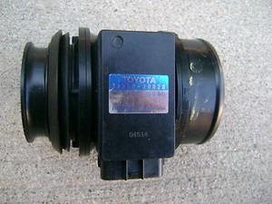

Not 100% sure yet, but may need new MAF and I'm checking prices.
Can't confirm the correct Denso part number, anybody know it for sure?
Part number listed on MAF on vehicle now (original) is 22204-07010.
When I search that number on the Camelback website, it shows replacement part number of 22204-21010 at $135.
On densoproducts.com, a search for 22204-21010 results in Denso part number 197-6020, but clicking on the "fitment' tab only shows that part number working for the Tacoma. Also, Amazon and Autozone say that 197-6020 does NOT fit my vehicle, and Rockauto only shows it working on 2000-2002.
When I go to the official Denso website and use the "Find My Part" feature, the result is "No Mass Air Flow Sensors results. We may not make this part for this application".

I used the 21010 number for mine, non California 4runner. No problems in two years. I don't believe the numbers were the same as the original one.

FWIW I installed the one you're looking at in my 01, not sure about a 99. Paid $72 and change from Rock Auto. Works fine.
Link to MAF Here
Just don't strip out the screws if this is the one you have.

I didn't know some '99s came with the older style. I have one of the last '99s (03/1999) and it has the newer screw-in style. That would explain why I also had difficulty with this p/n. Amazon application info sucks, btw. I always get my p/n somewhere else and ignore what they have to say. They are even worse on BMWs.
If I had to buy one, I would go with the one [MENTION=116467]Rock_Rat[/MENTION] used. It's also on Amazon for $70 and all 5-star reviews. Says it won't fit a '99 but fits '00 and up. This is only if you have the new style:
http://www.amazon.com/Denso-197-6020-Mass-Flow-Sensor/dp/B004J398Y8/ref=au_as_r?_encoding=UTF8&Make=Toyota%7C76&Model=4Runner%7C1005&Year=2000%7C2000&ie=UTF8&n=15684181&newVehicle=1&s=automotive&vehicleId=4&vehicleType=automotive

I agree about the Amazon application info, but when multiple sources tell me it won't work I get worried. That's the one I'm looking at, just trying to make sure I'm getting the correct one if/when I need it. I have a can of the CRC cleaner, gonna try that first to see if it resolves my issue. I called densoparts.com and they are supposed to contact Denso to confirm and get back to me.

Well lucky for you there are only 2 choices, the old style or the new style. There are no other variations between the two. So even if there are inconsistencies in terms of information you just have to look at what you have and just get that version. Hopeully you have the newer version.
Knowing which one I have isn't the issue - I have the newer style - it's finding the Denso equivalent part number.

That's the one I think is correct, but having trouble confirming it. Haven't been able to find a single site that sells them where it is confirmed to fit my year/model, or any posts on here where someone has for sure had it work in theirs.
Base it off a 2000 and it gaves you the same number on the Denso website 197-6020. Which is definitely the part you need. The reason you are not getting a definitive answer is because of the change happened during the 99 models.

Sorry to revive an old thread, but I'm having a similar issue. My truck is a 1999 federal emissions 3.4. I called Toyota and gave them my VIN and they said my MAF part number is 22204-21010. I looked at the MAF on the truck and it had the same PN. So I bought the amazon part here: https://www.amazon.com/gp/product/B0099AQMBI/ref=oh_aui_detailpage_o03_s00?ie=UTF8&psc=1
It came in a Denso box with the 22204-21010 part number, but when I looked at the actual part, it had the 22204-07010 part number on it. It looks the exact same as the part in the truck but the numbers are just slightly different. Monty, did you figure out the discrepancy?

From the Conicelli Toyota website (my goto on-line dealer):
MASS AIR FLOW SENSOR - TOYOTA (22204-21010)
List Price: $188.25
Sale Price: $126.76
ADD TO CART
Genuine Toyota & Scion Parts
Toyota Parts Scion Parts
Manufacturer: Toyota
Part Number: 22204-21010
Part: Mass Air Flow Sensor
Replaces: 22204-07010
https://parts.conicellitoyotaofconshohocken.com/oem-parts/toyota-mass-air-flow-sensor-2220421010
Toyota updates their parts numbers all the time.
