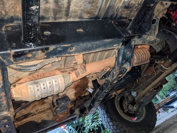

I am trying to replace my o2 sensors. I have a 1999 SR5, auto, 4wd. From what I have read it sounds like it should have 1 cat.
When I look under the vehicle it appears I may have 2 cats? Based off threads I have found I do have 2.

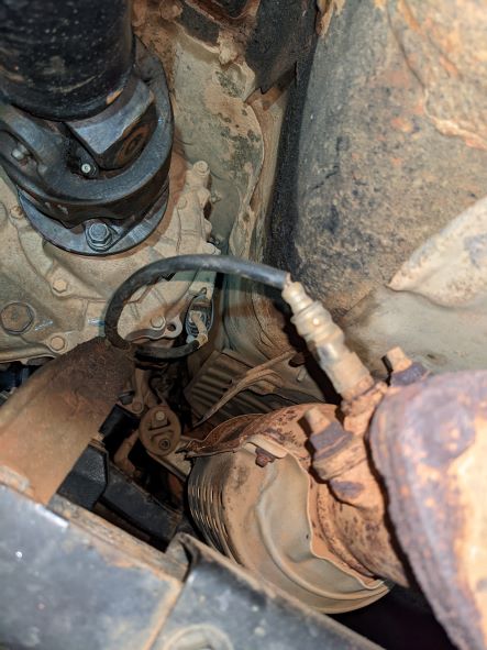

The rear however is way too short with the 234-4162. Mine has the little extension to support the extra long length wire. The harness it plugs into attached to the trans has no extra length to get the connector closer to the sensor.
I read that I would need the 234-4153 but it is also too short. On RockAuto it says the length of wire is 17" but the one I received from Amazon is only 3 or 4" long.
234-9002 is your upstream O2. 234-4153 is your downstream A/F. I'm assuming you got the wrong A/F because the lead is definitely way, way longer than 3-4".

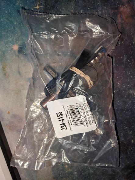

Thank man! That is what I needed to know.
The truck was originally sold by a local dealership here in Upstate South Carolina. Has lived it's whole life here. Part of my confusion was that I didn't think it would have been a cali emissions vehicle. The "Fed & Canada" bit under the hood made me think it was definitely a non-cali model. Then I started reading about how some 1999 models started to come with 2 cats for federal emissions and it started getting confusing.
I ordered another 234-4153 from Rockauto this time. Their description does list it as having a long ass wire. I do not know what the one I received from Amazon is but it does not have a 17" wire.
Thanks again for the quick reply!
Not a problem. I was in your very same shoes a year ago and ordered every single wrong sensor before getting the right ones (also V6 4WD with cali emissions, etc.). I'm kinda curious what you got too because the majority of the other options have different keyways on their plugs, so they don't even fit unless in the right vehicle. Maybe just strange luck
Also agree with above, findmypart is a god send
