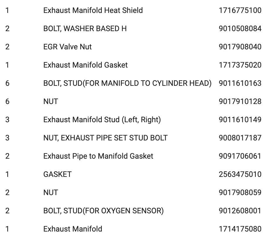

I just did this job 6mo ago and had a lot of the same head scratching you're doing right now with nuts/bolts/studs. I called multiple local Toyota parts departments and got some conflicting info than the video (but the video was a HUGE help, thanks Timmy & Jordan!). I created this doc to keep organized: 1997 4Runner 3RZ-FE - Exhaust Manifold Swap for Tacoma mini header - Google Docs The doc is the easiest source for what I purchased, but I also attached a screenshot of the parts I ordered.

One interesting thing is in the doc by chapolito, Toyota stevens creek uses part number 90179-10128 in place of 90179-10175 from the timmy video. My dealership used the 90179-10175, so it seems like there are some duplicate part numbers that should work.
