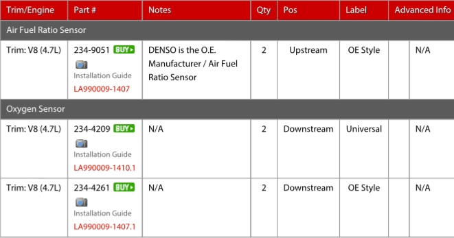

This is from Denso's website...

I used two identical universal Denso sensors for both upstream and downstream. The different part numbers are because one has a longer wiring harness than the other, but the sensors themselves are identical. If you look at the description of the universal sensors, most will indicate that it is used as both upstream and downstream placement.:trophy:
That shouldn't work, The AFRs in the front run around 3volts, The O2s run around a volt... when did you change them out?
