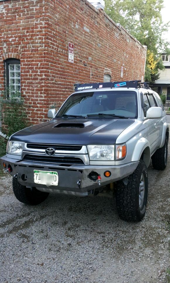

Well, HF did the trick... $14.99 for the grinder, $2 for the cutting wheel, and a whole lot of labor and I got the bumper mounted. More to come later in my future 'build thread'
very much still "in progress," but i think the hard work is paying off! i hit a deer a few Weeks back & decided to do a couple upgrades.

Good to see you got it mounted. I was going to say that I have a few grinders. The bumper looks real tight to the fenders. Remember that the body and frame flex seperatly and the bumper will come in contact with the body causing damage. I have about 1/2" gap and that seems to work well.
I'm not sure I can really do anything about that actually. The bumper is designed so that the winch plate rests on top of the frame rail ends and then there are plates on either end that hug the sides of the frame rails (*very* tightly). The whole shooting match is tucked up pretty tight to everything. Looks nice now, but I'll be pretty bummed if it flexes and starts causing other issues!

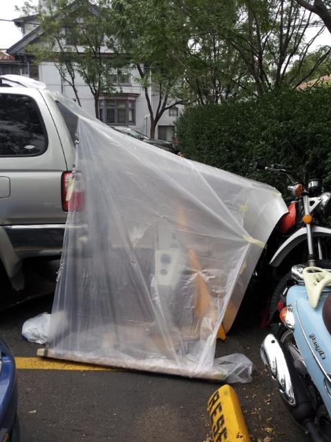

I think I'll be putting the last coat of paint on it tonight, so it should be done by the weekend. Note to self, don't take on a painting project without a garage...
