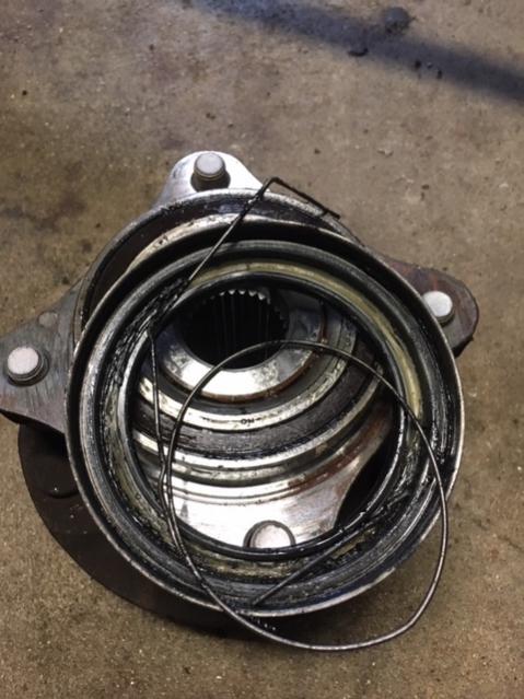

I just had that outcome here while troubleshooting a buzzing feel in my steering wheel during right turns at highway speeds. No audible noise, just a high freq low pitch vibration that felt like the steering wheel was buzzing.
I did the 12 and 6 o'clock test at the wheel with it jacked off the ground and there was no detectable play, wheel seemed to rotate smoothly, and stethoscope heard no noise at the inboard side of the hub while rotating the wheel...but brake pad noise may have concealed it.
I found a torn inner CV boot on the right (passenger) side and figured that was the cause. But during disassembly, I also found the outboard spindle seal (big metal base that presses into the backside of the spindle) had failed. The seal spring came out along with the CV splined end, rubber seal surface was trashed. When I unbolted the hub & bearing, there was water inside the bearing and bore, and the bearing was shot.
Both fronts were Marion assemblies installed just under 2 years ago, but given the seal failure I had no expectation of warranty...that's not his workmanship. He didn't reply to my email so I went with Blue Pit.
Lesson learned: always replace the spindle seal, even if it looks fine.
