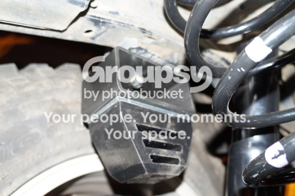

Also made some bumpstop extensions the other day. The metal supply place was out of the size I wanted, and the next size up was 3.5". I gave it a shot... but they're way too long. I hit bump in dips and over speed bumps now, and travel is definitely limited. On the trail they're perfect, so I'm leaving them until I can simply get some taller coils.

Here's the bumpstop.

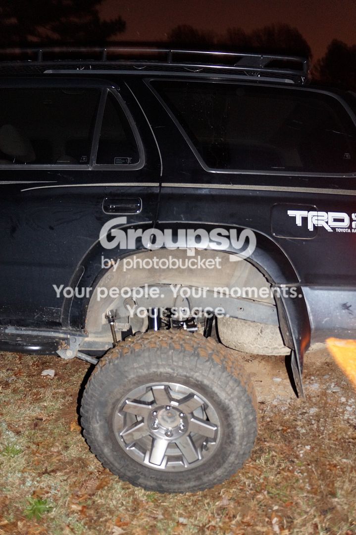

Here's the truck fully almost fully flexed, the poly bumpstops compress just a little bit when it's fully flexed. When I hang a tire the other side stuffs pretty good.
I actually made a few extra sets of these thinking some members would want them but I guess not haha. Live and learn. Hopefully you don't mind me posting all those pics, just thought they may help.

As for the bumps, I think my biggest problem is the wheel spacers- I can't flex much more than in my photo, as the tire then hits the fender. I should probably remove them... Needed them with the stock wheels, but with these, they're pointless really
