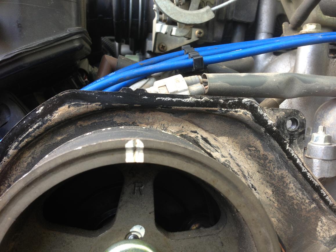

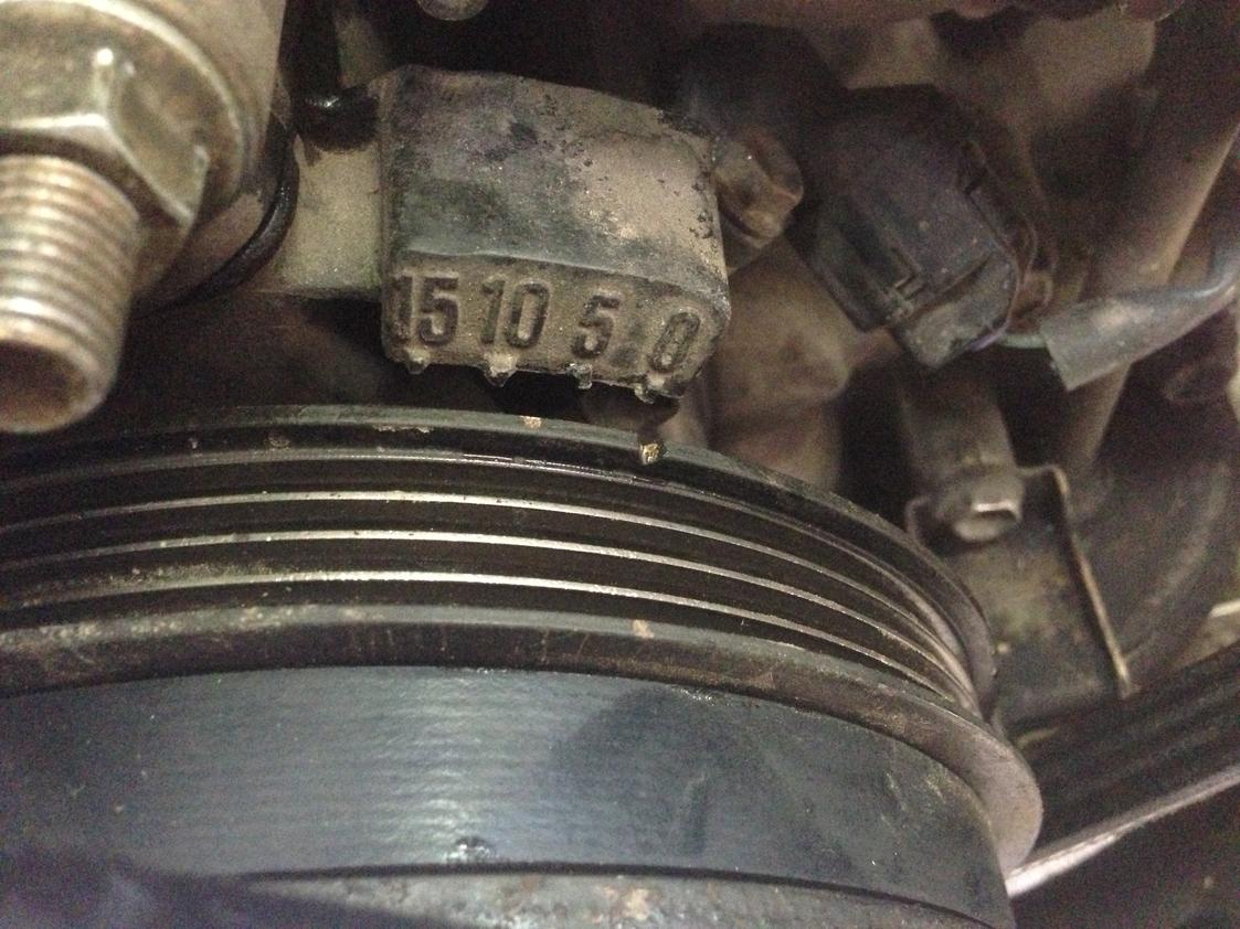

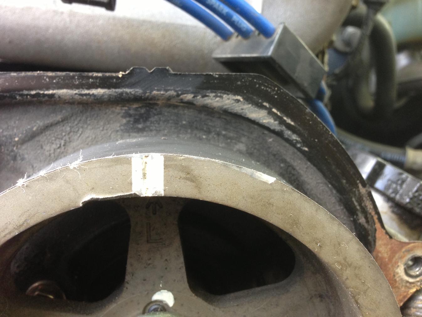

So I spent the last 3 days changing out my timing belt, tensioner, water pump, etc. I followed the manual as well as a few write ups in this forum. Everything seemed to go well until I started it up last night. It was extremely loud, like it was idling in the 5,000's, and made a ruhruhruhruhruhruh noise. This morning I went to verify that the timing was still on, and from what I can tell it is. I took some pics....is there something obvious I'm missing with the timing? I might try and get a video of it and post that as well. Can I fire her up without the fan on, as long as the pulley is still bolted down?
I have no clue what to do next, and any and all advice would be greatly appreciated

Quick Google search shows several people with a similar issues (your idle is higher), but I only saw two with clear resolutions. One guy had to drive his for a few days and it went back to normal, the result of the computer taking a while to relearn everything. Another fellow had to replace his engine coolant temperature sensor. Some other suggestion by other folks were to clean the IAC, make sure you didn't damage any sensors and/or their wires, check for vacuum leaks, and make sure your throttle body is closing as it should.
