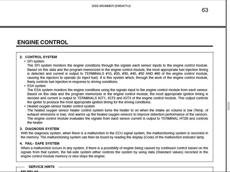

Factory wiring diagram manual
4. FAIL- SAFE SYSTEM
When a malfunction occurs in any system, if there is a possibility of engine being caused by continued control based on the
signals from that system, the fail-safe system either controls the system by using data (Standard values) recorded in the
engine control module memory or else stops the engine.

well i have talked with my father inlaw(a senior tech for toyota with 25+years of dealer work under his and another 10 before that for independent shops, been sent to numerous schools by toyota, and know the vehilces backwards and forwards, talked with another tech athe local dealer, as well as the parts manager(who used to be a tech and also has over 20 years with toyota, and campaigns a toyota race car) and all of them agree that toyota has no fail safes for this motor.
supporting evidence (as t4r4life pointed out) the cash for clunkers program, how come none of those fail-safes prevented damage? rods braking and punching holes through blocks, how come no fail-safe prevented that?, the "pink milkshake" how come no fail-safes prevent those? over heating and warping heads or cracking heads/scoring cylinders, how come no fail-safes prevent that from happening all of those things cause far more serious damage than simply over heating the trans or over filling the coolant expansion tank. while ok maybe it might be "programed" into the computer system, it has never once worked... and thus it does not exist for our vehicles. i stated earlier that if it was there, then it would trip a code and be stored i the computer and it would tell you that your vehicle was shut down to prevent damage. -find me the code for this.
you can drain the trans of its fluid or over fill the fluid and run the vehicle... you can drain the coolant, or over fill the coolant and run the vehicle... you can drain your oil, or fill it with twice the amount... you you can have the timing off at any position you want it at your(it might not actually run depending on how far out you have it, but it will sure try) vehicle will not automatically shut down to save itself. but if you feel so convinced that it will feel free to try either of the above methods and report back your findings.
just because you find a document saying something exists does not mean it actually does. dodge claimed in 2011 its newer 6.7 would produce 350hp and over 800ft-lb... well a bunch of owners started disputing these clames and guys started testing it... turns dodge was not even close, 320hp average, and around 680-700lb-ft... they went after dodge and dodge finally conceded and offered all 2011 owners either to buy back the trucks or to re-flash the computers and bump them up, what they didnt do was upgrade the torque converters in the auto trucks to handle the added power, and so there was a lot of trany failures premature (cummins also supposedly has fail-safes in place to prevent catastrophic damage... funny they didnt work either). while the late model 2011 trucks got updated torque converters to handle the added power to meet dodges claims. but mileage suffered tremendously with both trucks as a result. and the DPF and emissions systems started failing, thus the class action lawsuit's filed against Chrysler. my point here is again, dont believe everything you hear or read. -i dont even think 4th gen 4runners or 2nd gen tacos have fail-safes.
speaking of fail-safes, if you have a friend or know someone with a newer say 2011 or newer BMW like a loaded 7series, here is a cool little trick to play on them... if they are driving(only do this at slow slow speeds like backing up out of a parking spot or pulling into one, and be safe about this), open your door, just a crack... it will automatically put the car into park and stop the car, the driver unless he knows about it will be like WTF!? -we would do this all the time at the dealer, some tech or lot attendant would be driving by moving a car(slow speeds again, under 5mph in the shop) and we would open the rear door as the car passed, about 2 sec later boom park and the driver would look around like WTF!? it was great fun, untill some idiot lot attendants got into it and swung open a door on a car that didnt have this feature and it hit another car and almost ripped off the door, $9000 later and one less lot attendant there was no more fun and games to be had at BMW. so be smart about this guys. dont try this on the fwy at 60mph(i honestly dont know what would happen, i have no idea cause none of us were dumb enough to try it), and dont swing the door open or let go of it, all you have to do is just open it so the open door sensor is tripped like what it would take to trigger our idiot lights.
(added 11/20. It may have been my Coolant Temp idiot light, but this does not change the fact that my engine did shut itself down to avoid damage).
My 4Runner Brother, Thats all I've got right now. My experience + Toyota Factory Manual with authentic translation errors.
Does your father in law have access to the 2002 Electric Wiring Diagram? Will he please look at Engine Control diagrams, which I think are in the System Circuits section listed in the index? Please ask him to see if there is text after the diagrams. Does that text have the heading 'SYSTEM OUTLINE' with 4 sub categories, 1. INPUT SIGNAL, 2. CONTROL SYSTEM, 3. DIAGNOSIS SYSTEM, 4. FAIL- SAFE SYSTEM (capital letters from copy/paste, not me yelling).
If he can and that is there will he please explain what 4. FAIL- SAFE SYSTEM refers to/describes/means/yadda yadda? Please ask him what "...malfunction occurs in any system…" ...fail-safe system either…" "…or else stops the engine" means. I would really appreciate it if he would be willing to do this because I would love to understand it.
If he does not have access to the manual would you please forward the screenshot I posted? I think I can send you all 9 pages of the Engine Control section if you pm me. Can I attach images and such in pm's?
