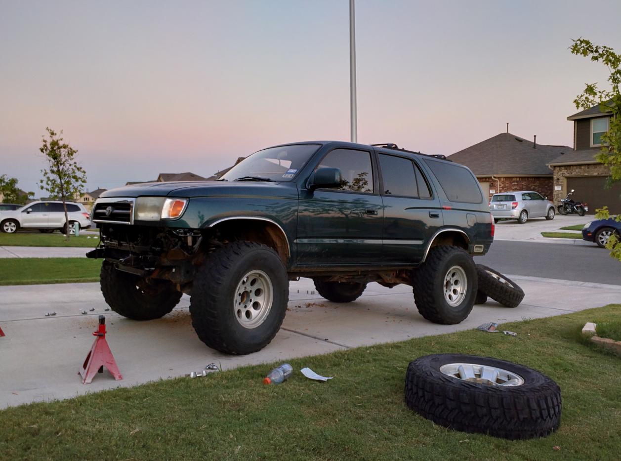

I posted an old picture so I didn't get the "This thread is useless without pics!"
That was after the Texas Jambo this year. The park was terrible and muddy. Usually it's firm and dusty.

I would but I was only able to check on it before I went out of town. (And shed a few tears) uploadfromtaptalk1438040530214.jpg

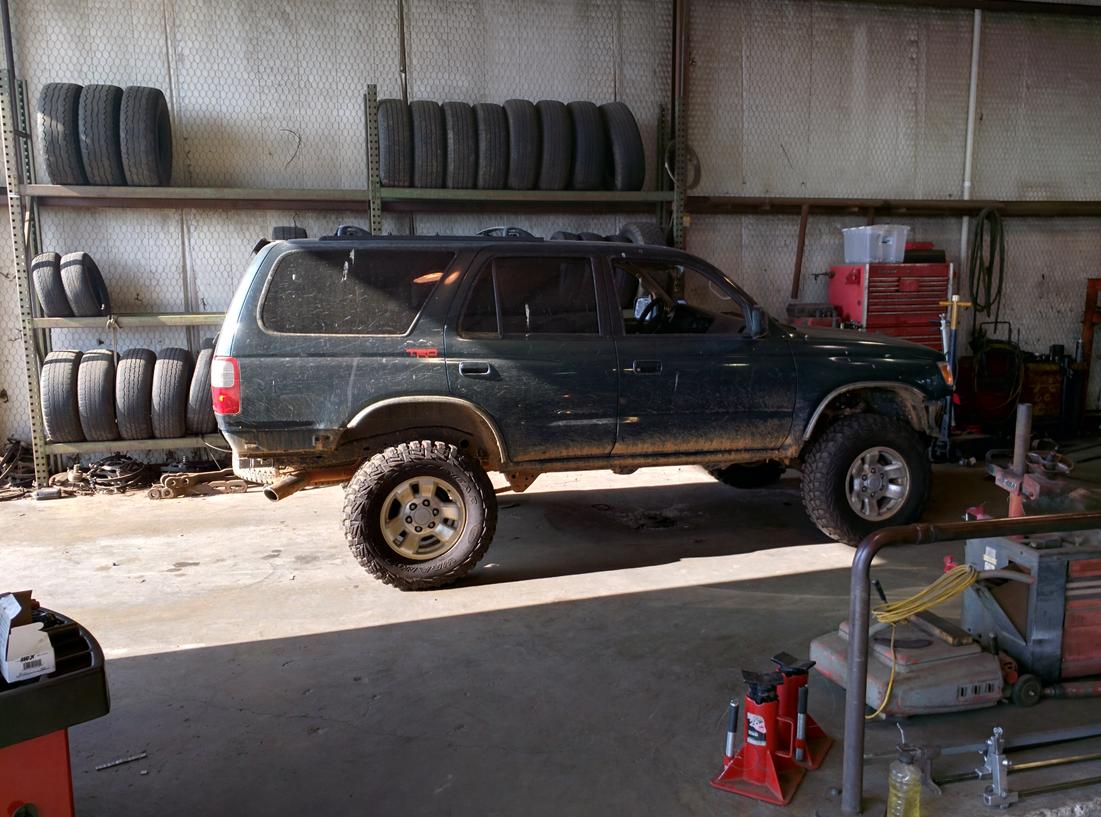

uploadfromtaptalk1438700309179.jpg Slapped on some 315s. It decently needs a body lift now but the gears are perfect. More throttle response than with 4.10s and 265/75s.
