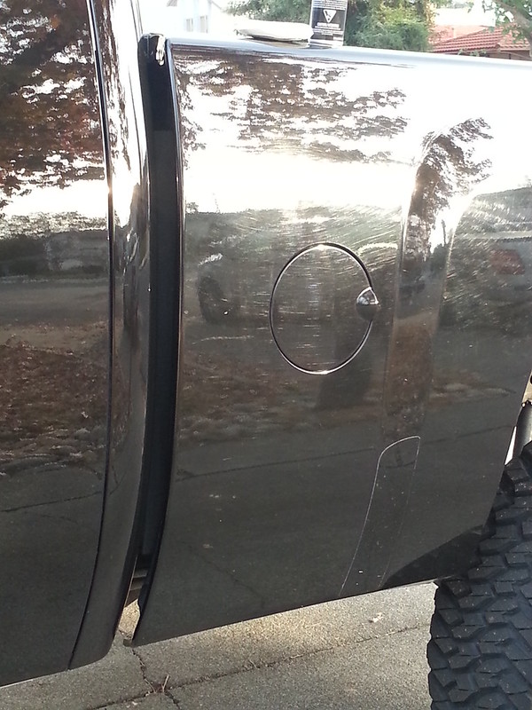

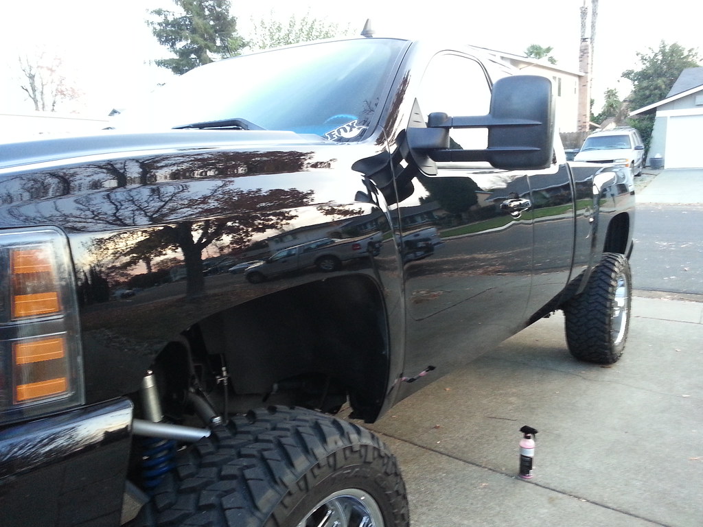

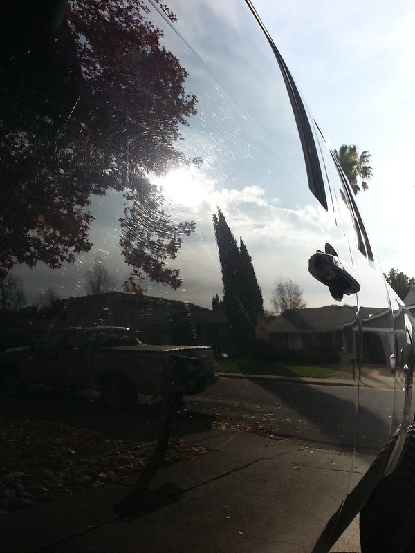

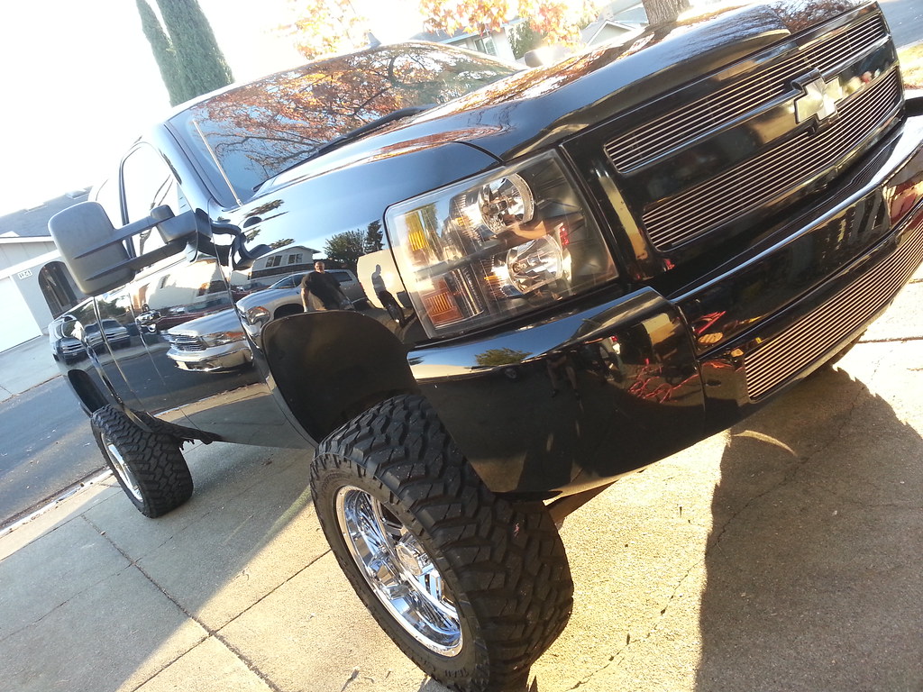

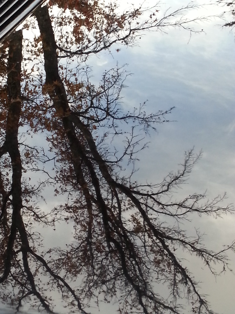

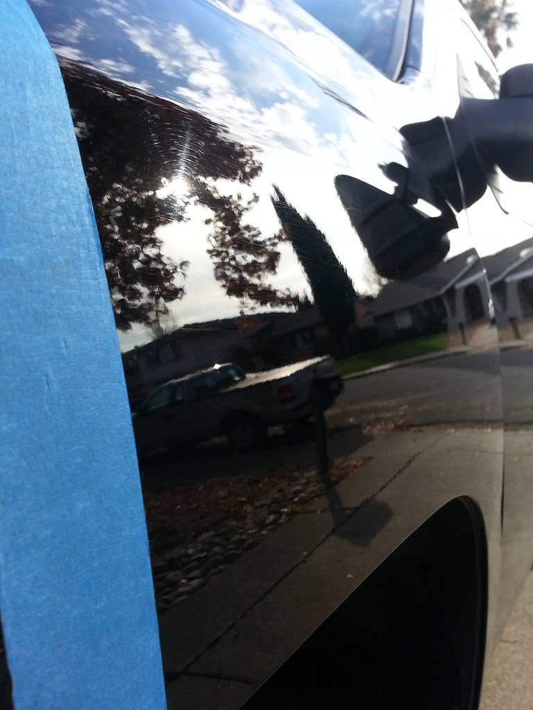

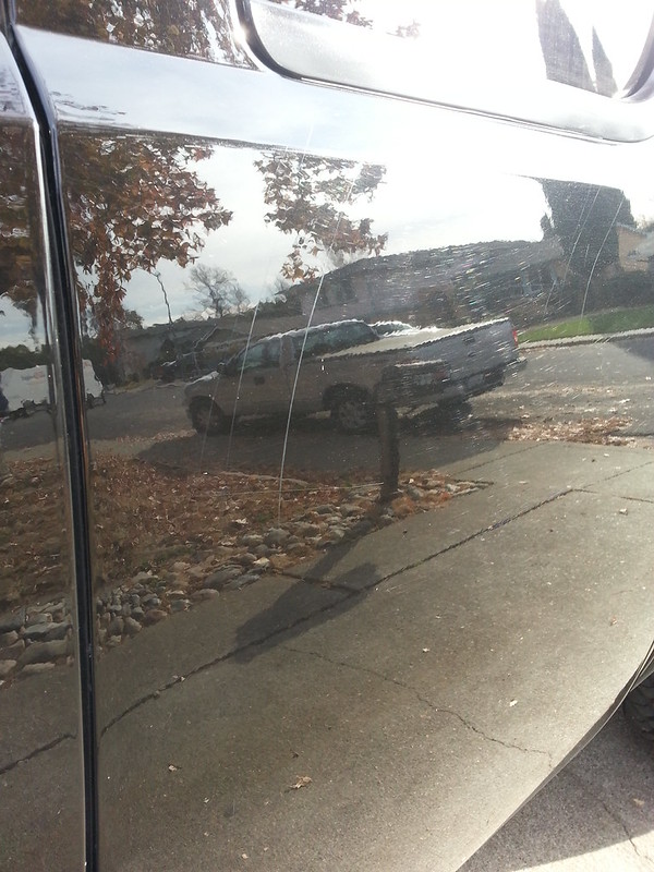

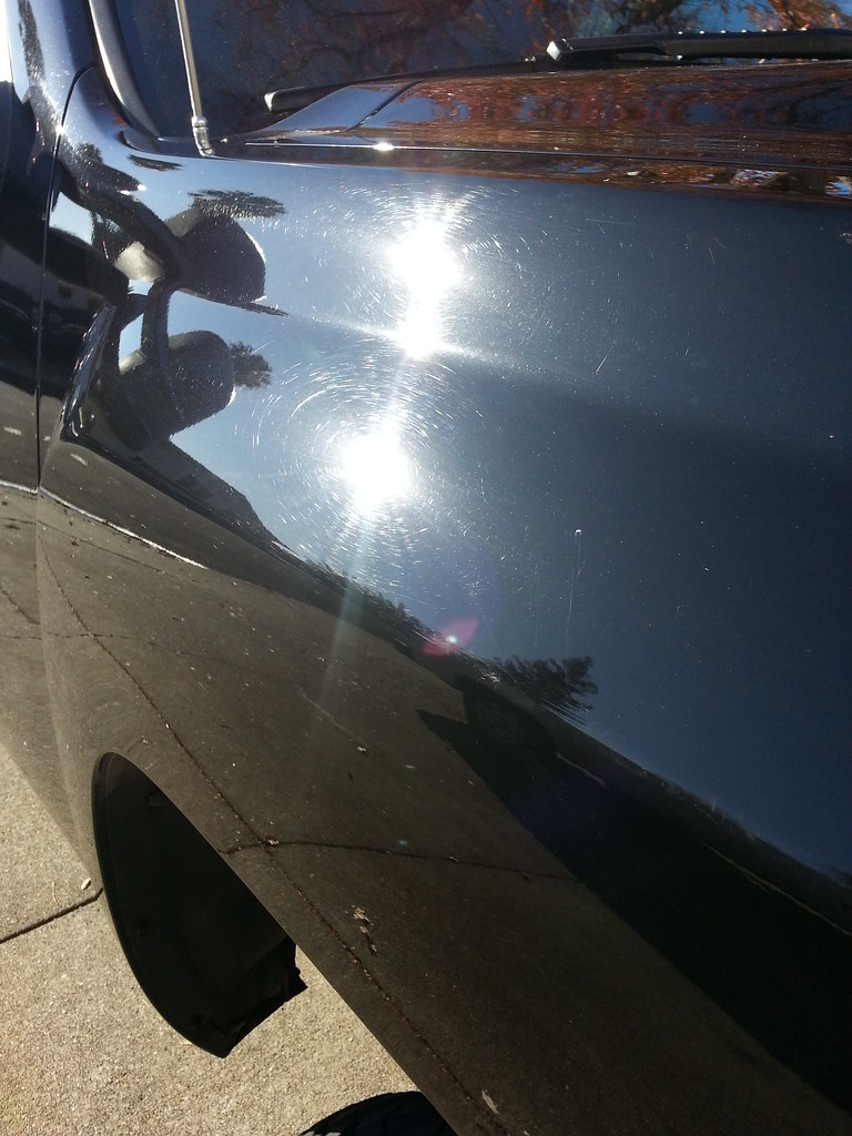

Recently my dad acquired a friends truck. Very nice truck but his first thing was the paint. It was beyond trashed. So he had me detail it this week. I have about 16 hours into this and thats paint alone.
What I Used:
Strip wash with APC in Foam cannon
Clay
Adams new 2 step
5" MF Pads
5" foam pads
Alcohol wipe
Sonax Polymer Netshield
Brilliant Glaze
Adams Americana
50/50

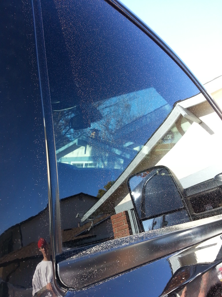

I've never seen something dust as much as this did

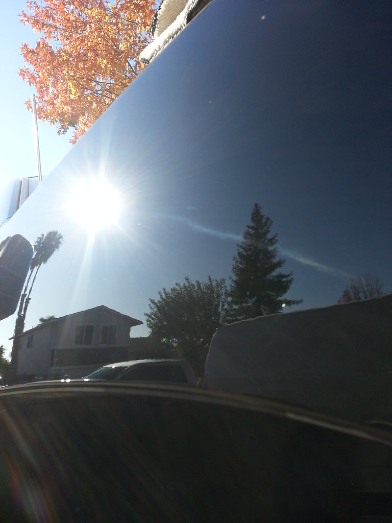

Favorite shot
Turned out well. I'm always impressed by people that have the patience/focus to do a job like that. I would get lost in the details and it would take me 3 weeks. Out of curiosity, how much do you charge for an exterior correction like that?

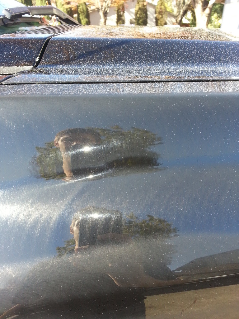

this one is the worst one i've ever done. I usually have people who at least have minor swirls, nothing like this was. It looked like it was washed with a brillo pad.
A job this heavy, hour extensive would probably had been around $500-700 just because of how much i had to do. But thankfully for him its my dads truck, so free.

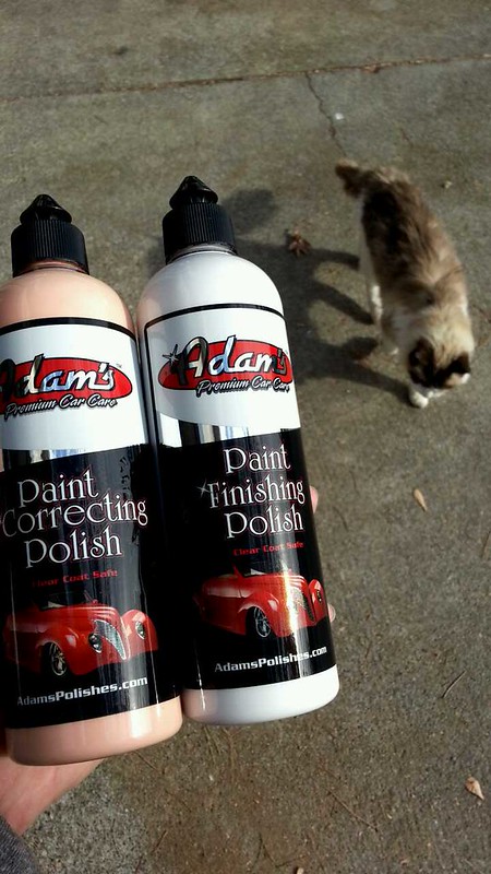

I would personally use Adams Revive Polish. You apply it by hand and it will brighten the paint if its dulling. Then wax after to protect the paint.
Automotive Detailing Supplies | Fine Polish | Hand Polishing
Nice applicator to use
BLUE Hexgrip Car Polish | Applicator Pads | Auto Detail
If you buy from them you can use FULLSIZE in the discount code. Its a 15% code off another forum I'm on. Im in no way affiliated with Adams but they have good products at good prices on certain things.
