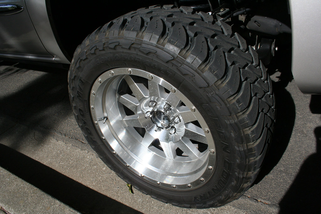

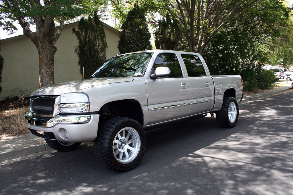

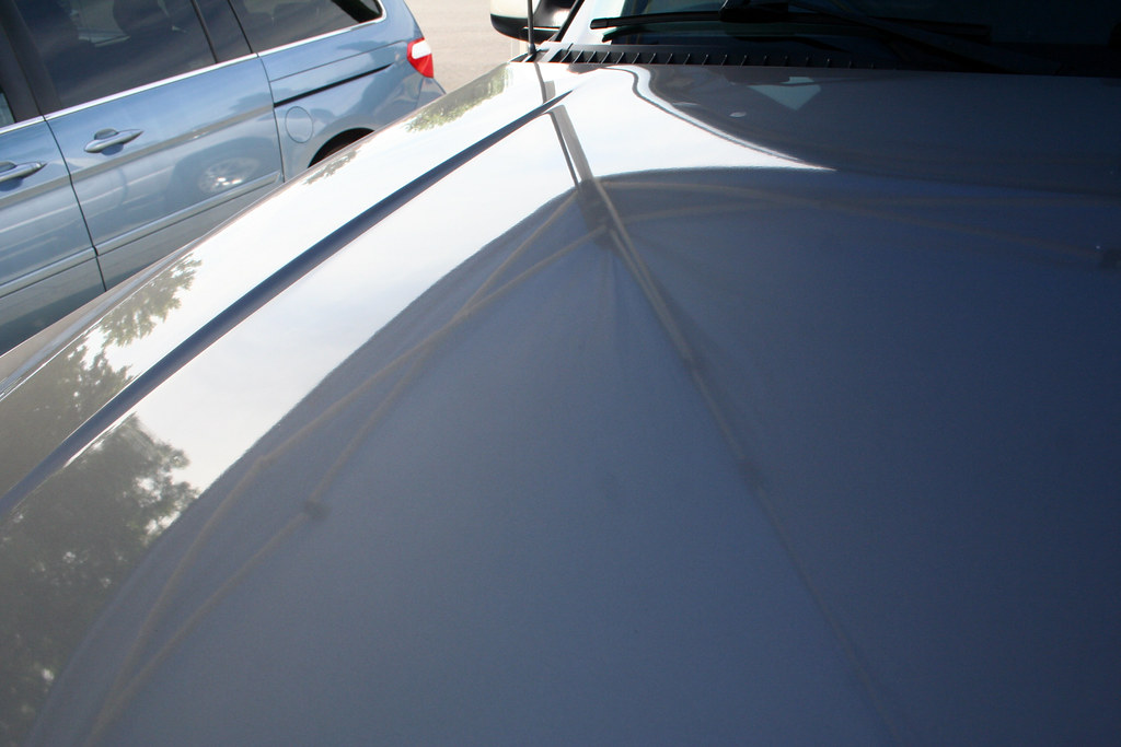

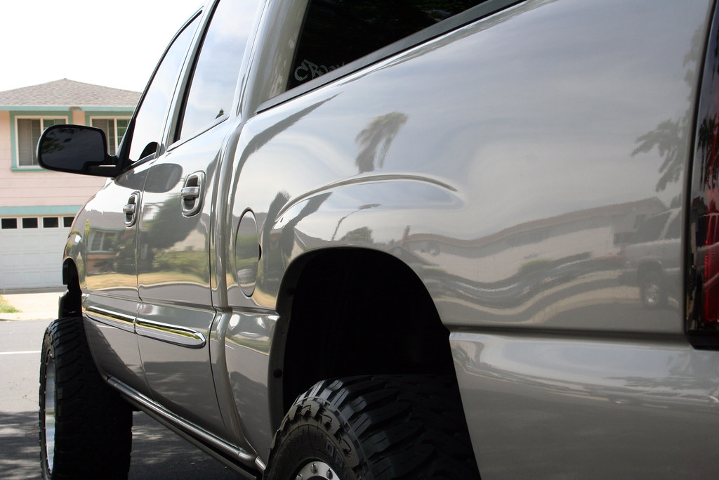

This truck came in for a quick polish/seal exterior only detail. Below are the pics in order. Its hard to photograph Silver Birch through the changes of the paint but i can say it made a large difference in the depth and overall appearance of the paint. Its also now protected for daily driver duty for months to come. It was a hot day today, 100* so i started early and kept a slower pace to ensure it wouldnt catch up to me. Overall this detail took 5 hours to complete. Also good tidbit, zero water was used during this detail. You're welcome CA.
Process:
Rinse free strip wash
Clay bar with medium cut

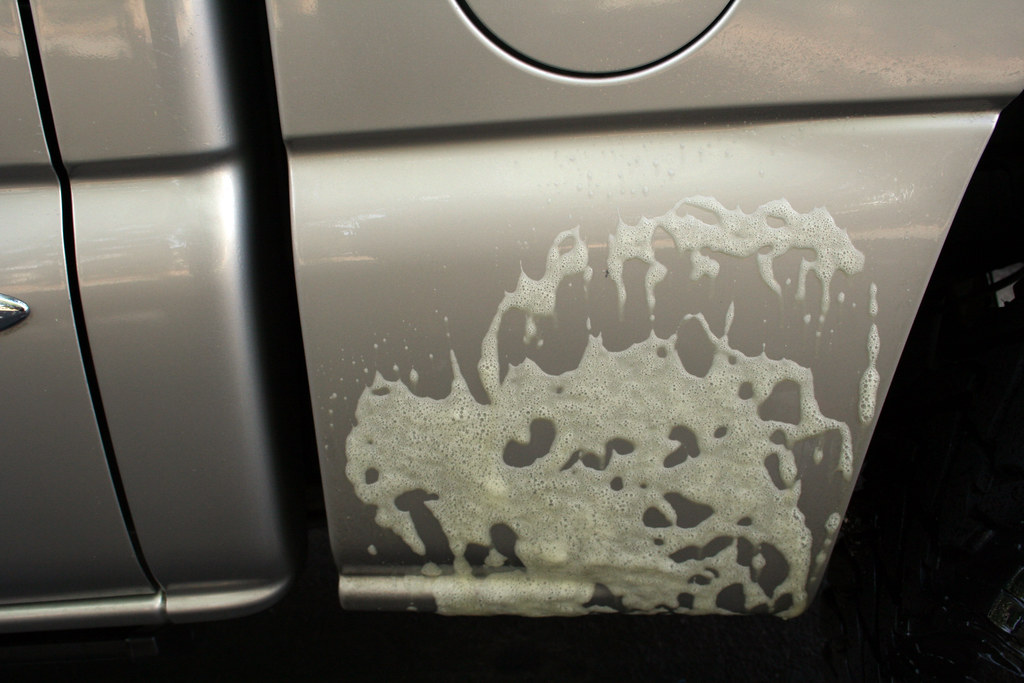

Paint decontamination on the bed lower panels with SCG Wheel cleaner to remove hard water stains/etching (70% removed)
Orange medium cut foam pad w/ Flex 3401
AIO polish
Acrylic Paint Sealant
Sonax Polynet Shield on the wheels topped with a coat of Brilliant Glaze
All chrome topped with Brilliant Glaze as well as glass
PERL tire/trim dressing
In N Out spray on the cowl/plastics

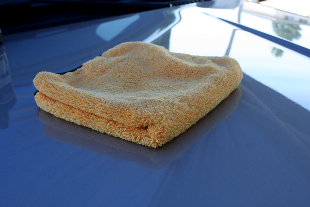

On a side note, what brand of micro fiber towels do you use? This last package of micro fiber towels from costco have a ton of lint and fibers that come off anytime I use them. The last several packs haven't been like that.
