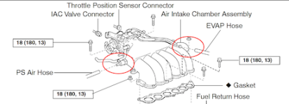

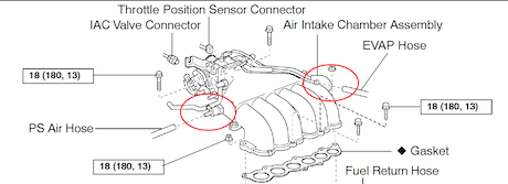

I just did the intake vacuum test. I'm not entirely sure what to make of it. Note that I'm at ~5500' elevation. If the correction factors you'd use for compression testing apply to vacuum, and I'd guess they would but I really have no idea, then I'm pulling vacuum that's within spec.
My uncorrected readings were ~16.5 in.Hg at idle, staying totally steady up through ~3500RPM, then increasing to ~17.0 in.Hg at ~4500RPM.
The correction factor I'd use, if it'd apply and if it's actually right, I got from this thread: http://www.toyota-4runner.org/3rd-gen-t4rs/170087-compression-test-question.html, 0.853. That factor would move the spec from 17.7 in.Hg or more to ~15.1 in.HG or more (since the compression readings are done in PSI, I converted to PSI to apply the correction. I'm not a math wizard so maybe that was wrong and/or unnecessary).
Correction factor aside, the fact that the vacuum stayed stable and even increased at higher RPMs seems to suggest there's no issue with the motor being able to breathe. This was however done in a parking lot, not with the motor under load driving down the road, which maybe could make a difference? The car was warm before I tested. I tested at two locations and got the same results. One where one of the "PS Air Hose" connects (I think), and one where the EVAP connects.
