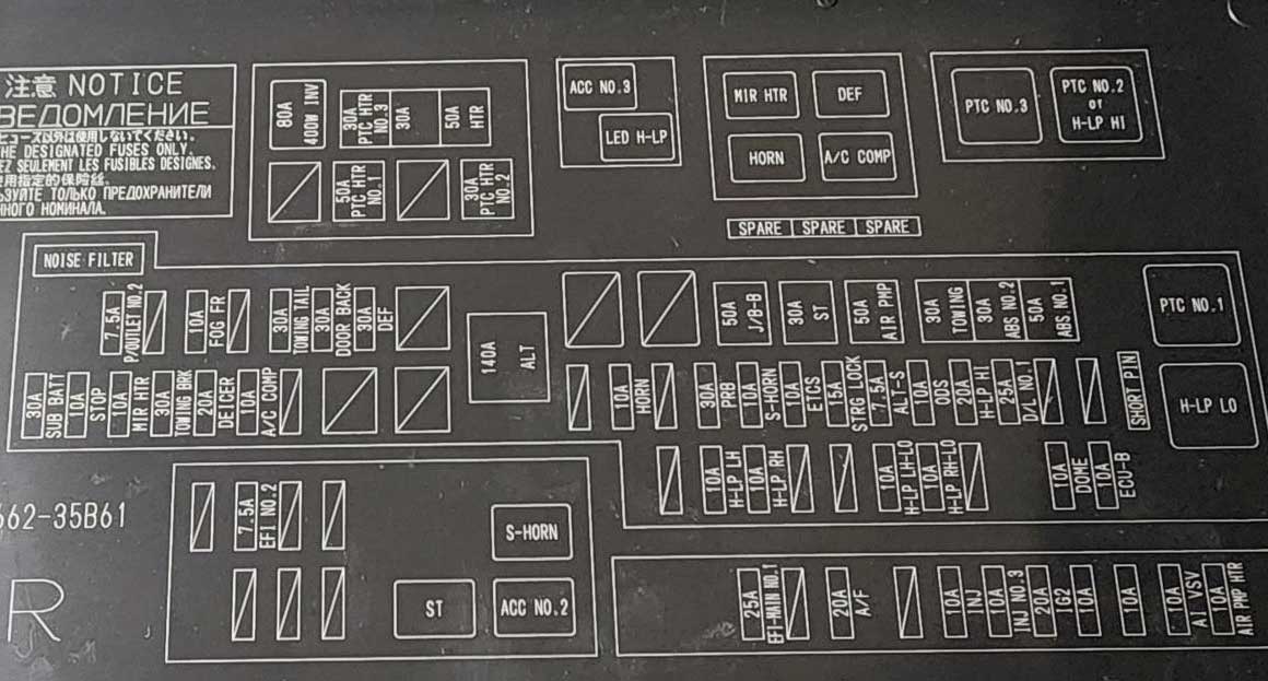

First, I can't find a Fuse Diagram that looks like what I have. I'm looking at imgVEHICLE.com but that doesn't look right.
I haven't tested the circuit across the window yet.
Seems to be some relationship between mirrors and window but can't find anything.
Obviously there has to be something like a limit switch controlling the wiper and heater. Could there be something with the switch that allows wipers but no defrost? Possible??
Thanks in advance for your thoughts.
Sorry for the large photo. This is my actual fusebox cover.
Everything works except no defrost.
The MIR HTR is a relay. I'll check it but wouldn't think that would go out in 3 years.
But stranger things have happened.
Edit
OOPS
Just noticed the 10Amp MTR HTR fuse
