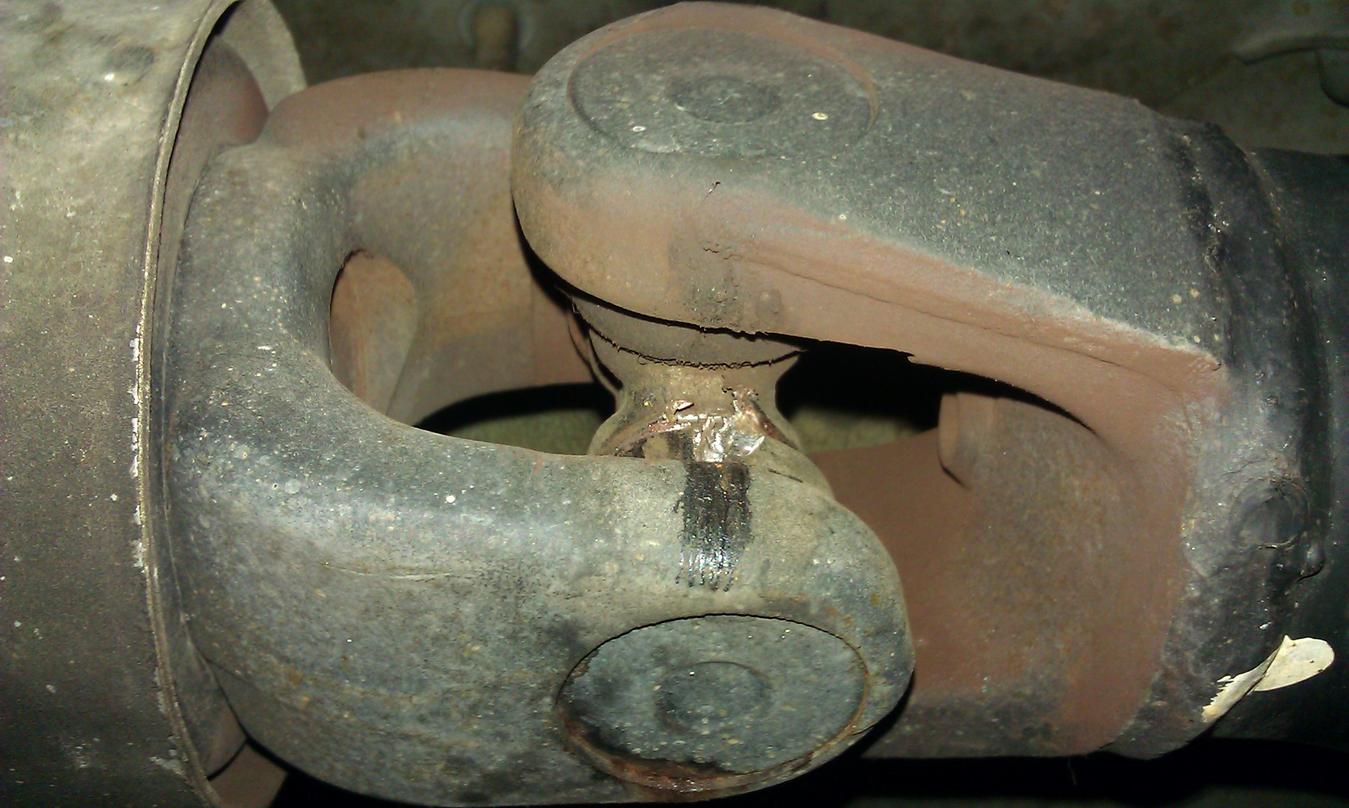

I think I found the problem. And yes, there are a gazillion YouTube videos of how to change a u-joint. Changing this will be easier than the engine mounts, and I get to use a BFH!
When you have a flange with bolt holes, I had good luck screwing it to a block of wood so there's something for the vise to hold onto. Oh, one of those is rusty inside and that is your squeak.
Yeah, one of the bolt holes in the vise flange is broken, so only two left. Of course a real work bench would be nice!
Yep, I'm hoping you're right about the squeaking coming from here. I wish I had noticed this when I was down there looking at the tranny mount.:redbrick:
