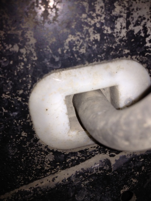

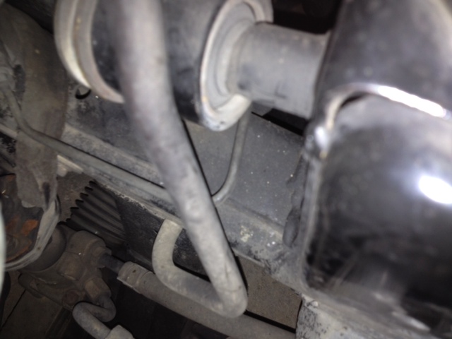

That plug goes connected to the chassis, yes the chassis. Just took 2 pics from my 4Runner. Check them out.

You rock, brother. Thanks so much. I'll get on this pronto. Just plugs right back in to the chassis?
Well, that's what I can see. Didn't try to take it out to see how it is kept in place, don't wanna end up breaking something. Is located right in front of the manifold, too much heat, parts get brittle, you know. :nono:
Seems that is just a matter of getting it properly aligned in front of the orifice, and then push it gently.
