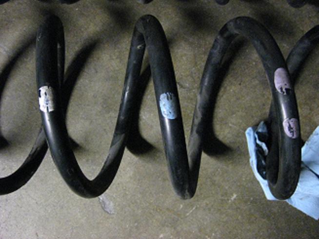

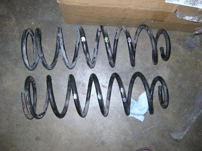

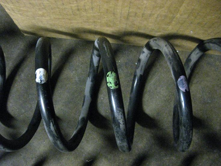

[MENTION=105701]diggity_1031[/MENTION] post a picture of the springs and the color codes if you don't mind. Also I replied to PM.
It looks like the fronts gave you the ~1.75" of lift.
The rear, I'm guessing the LC coils were used, or should I say used up. 8 wraps should give you ~3.5"-4" of lift. OR, if you have a lot of weight in the back, the LC coils will squat and are a bad choice.

Taylor20 here are the springs.
