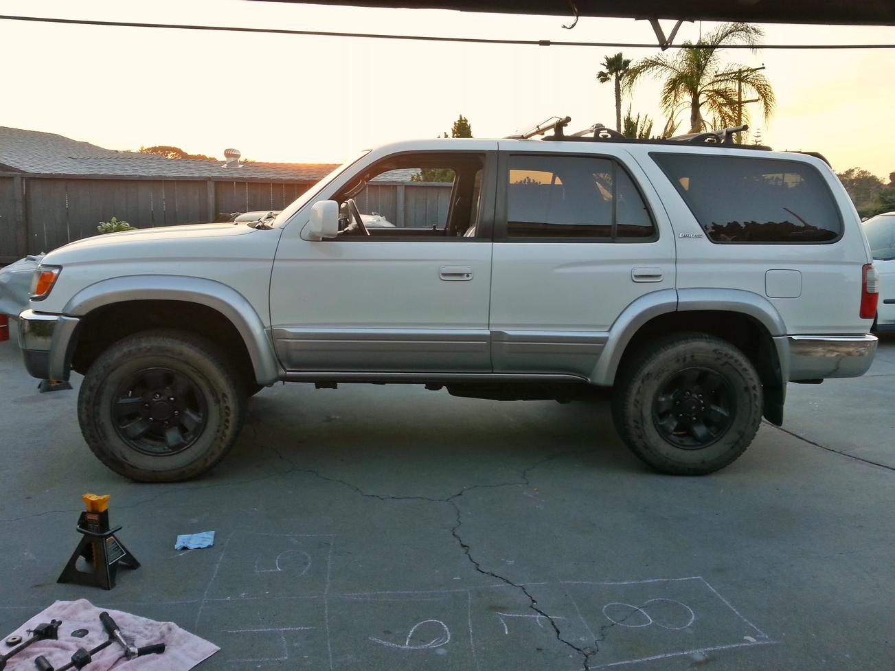

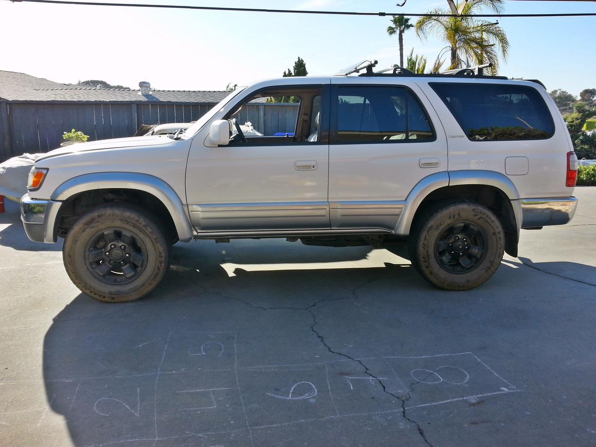

After all the researching and anticipation I finally got around to doing the lift. I got the front struts from and 02 Tundra TRD bil.4600 and rear landcruiser coils that I believe to be 8 wraps. I did the fronts no problem and actually liked the way it looked but the rear was way too blown out and saggy and heres the results to that. 20140221_153007_HDR.jpg

Those of you with experience doing this lift.......will it settle? I hate the look and was gonna go back to my stock tired coils in the morning or have the neighbor torch a coil or two until i can buy some OME springs

8 wraps and TRD tundra coils are not a good combo... the 8 wraps give 4+" of lift and the tundra coils will only net about 2"... do not torch the LC 8 wraps, sell them and use that money to offset the cost of some OME906s or the like. cutting the LC coil will not get you what you want and you will not have any resale value to them when your done.

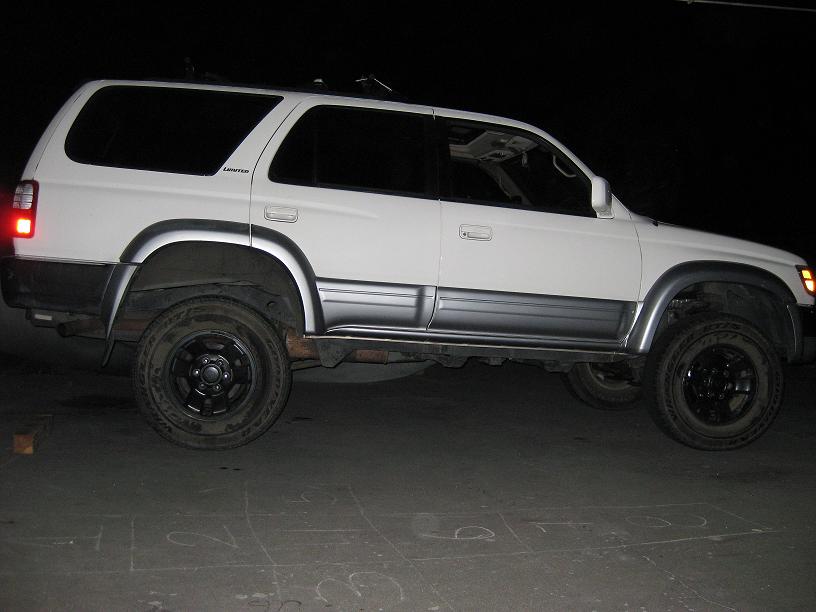

I wish I could tell exactly what LC coils you used.
I have the SS 1.2A setup which is similar to what you describe although I'm not sure if you used the same parts.
There are pics of what it should look like in my signature.
What are your hub to fender measurements for front and rear? Doesn't seem like the front came up much at all and then paired with 8wraps with no weight. Leads to a lot of rake.
I ran this TRD tundras with LC 7 and 9 wraps and never got anything like this.
just saw some threads where people run them with the 5100 but I also seen a couple of threads with people running them with the 4600s with no problem. Guess I shoulda looked a little harder for the color codes on the springs.
Ignore my 2nd comment, didn't realize the first pic posted was a before. DOH!
