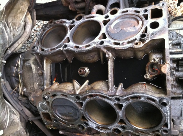

I just finished tearing down a 3.0 to the short block today, first time. Your sentiments about Toyota engineers where the same here. Don't kid yourself, this is a big job and to top it off, the knock sensor is expensive. If you do the sensor, you may as well do the timing belt, water pump and head gaskets. Yes, that is just about how far you have to go to replace the sensor. Have no idea what happens if you leave it.
As an FYI, I tried to post a question earlier with pictures of my short block with the knock sensor dead in the middle of the picture. Will try to attach to this post so you can see it.
