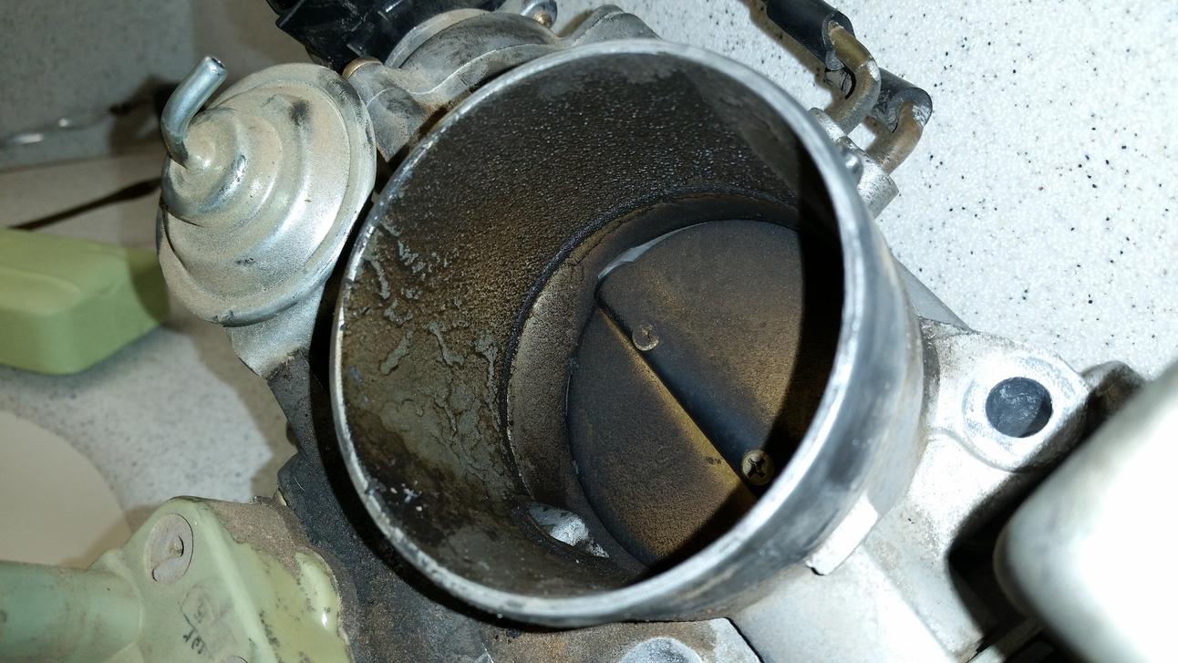

so this is what my tb looks like. i havent started cleaning yet, that wetness was already there
Well, that TB could certainly stand a cleaning.
