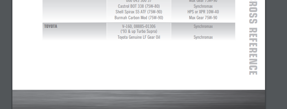

According to RP it is a direct replacement.
Syncromax_zpsmtbeugne.png~original

My 2011 Owners Manual indicates to use SAE 75W Toyota Genuine Transfer Gear Oil LF, and my research led me to Toyota Part # 08885-81080 (which is different than what is shown in your RP pic).
[MENTION=96475]zonzin[/MENTION] ...
So the RP table seems to indicate two different Toyota fluids, The top spec is for an older version of the Toyota fluid, V160... and the second row spec is the Toyota Genuine LF, which is 08885-81080 . Both have the RP as a replacement.
Well, that's what I thought, too, until I called them. I was told that it was a "performance upgrade" (or something like that) and not a direct replacement. Not sure what that means exactly, but I took it to mean the fluid is fully compatible only RP is not willing to stand behind their claim. The technical specs of the fluid appear to be as good as or better than Toyota LF gear oil.
Either way, it's working great in my 2016!
PS: I just realized that I posted the Synchromax product sheet, not the Cross Reference document that you posted (which I originally meant to post)... thanks for catching that!
