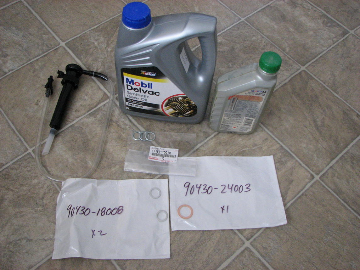

Here's a how-to thread.
http://www.toyota-4runner.org/5th-gen-t4rs/117482-front-rear-diff-fluid-change.html

I am guessing the 90430-18008 washers are for the T-Case?
Yes. But the part has been superseded.
Differential Fluid Change
GASKET, DRAIN PLUG - ALUMINUM DIFF (REAR:2 FRONT: 1) 1215710010
GASKET, FRONT DIFFERENTIAL DRAIN PLUG.* (QTY:1) 9043024003
Transfer Case Service
TRANSFERCASE GASKET DRAIN/FILL (QTY:2) 9043018008
Superseded by: 90430-A0003

Thanks for the information :thumb3:
