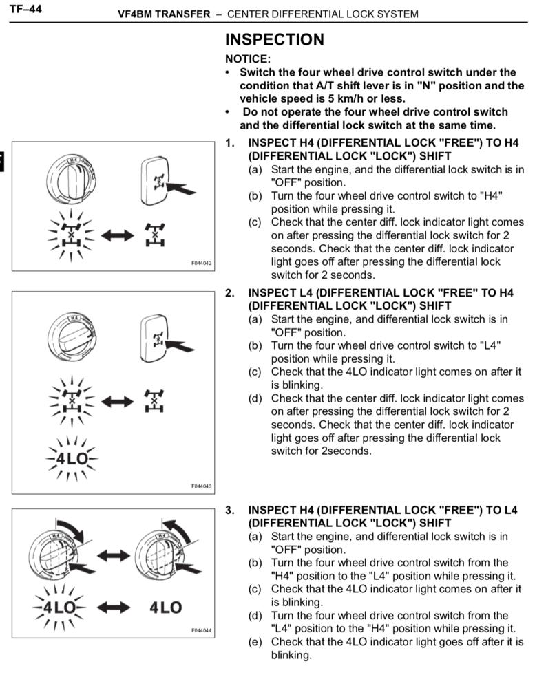

I believe you have to press and hold the switch, not just tap it. In neutral, hold until engaged, or disengaged. It says something about the proper technique in the manual. I can look it up if you don't have one.
Why not use the issue as a negotiation tactic to have them fix it before purchase. Seems like you have some leverage when it comes to price.
Nope you just have to tap the button, it will engage and the light will go solid.
