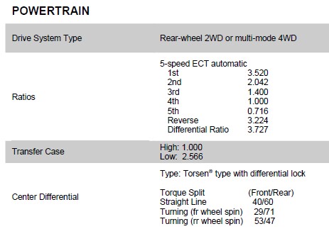

[MENTION=66389]BlackWorksInc[/MENTION] do you happen to know the gearing for the transfer case off the top of your head?
4lo in low gear is a lower gearing than 4hi in low gear, high vs low is a bigger difference in the transfer case
center diff lock sends the same power to all 4 wheels, think like subarus symmetrical AWD although it may not be the same percent front vs rear
the previous gens were 2.28 low range. not sure if they changed it or not.
but, 4low compounds the gearing by whatever the low range is. using the above, you will be 2.28 times lower geared when shifted into 4low.
this gives you more control, and perceived power. better when the trail gets tough...

I can't give you all the detailed engineering terms, but 4lo basically makes all the gears "shorter" via final drive ratio in the transfer case. For example in 2hi or 4hi, 1st gear red-lines at about 25mph (rough est), where-as in 4lo 1st gear redlines at 10mph (again est.). This means you have the whole rpm range available to you over a span of 10mph vs 25mph. So what that means is in 4lo at 10mph you have the full power of the engine available to you, whereas in 4hi you would probably be at 3000 rpms, where the engine is making significantly less power. This aspect of 4lo doesn't really mean anything in regards to wheeling, but how this pertains to gear ratios in general can make a huge difference when towing.
The other main difference of 4lo can be explained via bicycle gears. Say 4hi & 2hi are when you're in the middle ring of your crankset (the front gears that the pedals are attached to) & the small ring (innermost) is 4lo. The middle ring (2/4hi) is fine for most situations, but you notice when starting on a steep hill or going over a big rock it can be hard to get your initial momentum. However when you shift into the small ring, it becomes much easier for your muscles (the engine) to turn the pedals, but the trade-off is your top speed is limited because your legs can only pedal so fast (RPM redline).
So basically 4lo is trading top-end speed for low-end grunt. It is also helpful for wheeling because it allows you to control you speed better by helping you crawl over obstacles in a slow and controlled manner.

Here's what the gear progression looks like from lowest to highest.
Low range
High range
1
2
3 - 1 Same
4
2
5 - Not available
3
4
5
