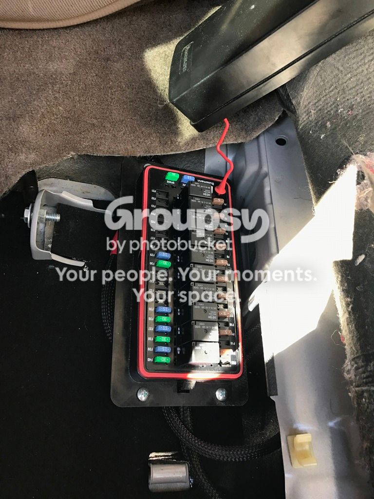

If you are electrical capable. You can install a aux fuse/relay box in the back under the seat. That's what I did.
I put my fuse box there too! No pictures though... it's not very pretty
All good. I'm sure it's safe.
This is what I did with mine. I ran 5 wires to the back. On the driver side behind the panel. And ran 5 wires in the front through the grommet inside the engine bay.
So with that said. When ever I add a light, or anything that needs power and relay. I simply tap into one of the wires either in the front or the back. The switch power wires are already pre ran to the front under the head unit. So I just install a switch. And boom. All done. No need to run wires, and the whole bs.
