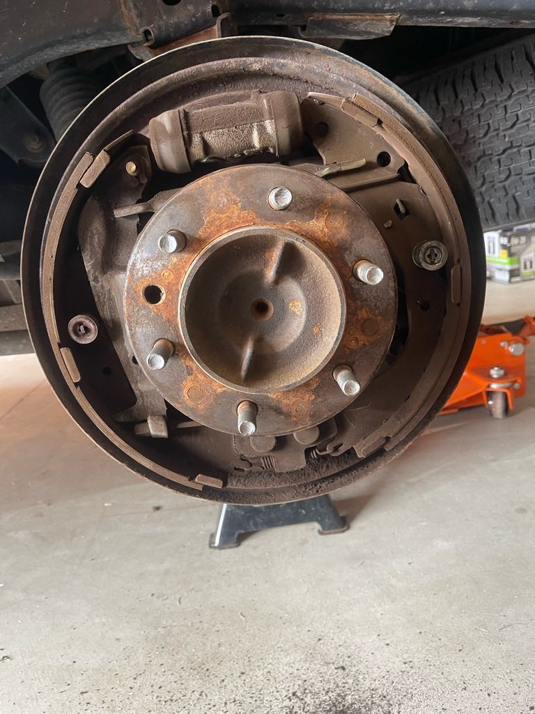

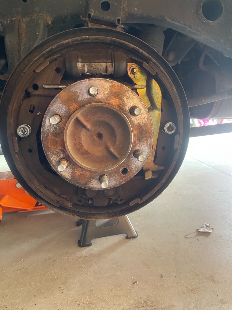

Wanted to take a look today before new pads come in. Is this just 23 years (180k miles) of brake dust or bigger problem? Thanks.

I think that looks really good especially for 180K miles. Are you sure they haven't been replaced more recently? Either way it looks normal to me.

Your brakes look great for 23 years old and almost 200k. They really aren't even worn out which is totally normal. For whatever reason Toyota rear drum brakes last forever. OEM brakes are probably the best, but any name brand premium brakes are going to be almost as good.

I’ve owned it for about 8 years and none of the service records that were passed to me showed rear brakes being done. Doesn’t mean they weren’t though, good point. Was quite surprised how well the hardware looked tbh and drums were fairly easy to pull off. The inside is caked in this dust. I’ve done alot of maintenance in my life, but have never done a rear brake job, wasn’t sure if this was normal.

Mine looked just like that when I replaced them too.
The drum inside diameter was fine also.
Notice in the photos above that one edge of each shoe is fatter than the other edge. Mine were the same way.

Those brake parts look fine, other than the worn pads. Be sure to clean everything up with brake parts cleaner before disassembling, lubricate the backing plate at the correct pivot points and either replace the drums or have them resurfaced. If they have enough meat, O'Reilly's will resurface both for around $60.
My brake shoes had a lot of dust and slightly uneven wear but it's common for them to still have that much life left at that milage. Shoes take longer to wear down, and they're located in the back which does less braking. I wouldn't replace them, if you get shaking you resurface the drums, the shoes don't cause that.
