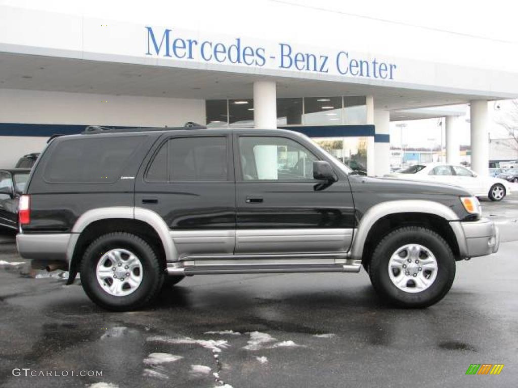

I have a similar question.
I have a 2001 4runner SR5 with the large fender flares. I scraped the left side of the truck against a concrete post and need to replace both doors and the front fender.
I found a 1999 limited and I was wondering if I could swap the doors from that or if I would need to replace all the SR5 flares with the limited flares as well?
Do you know if the holes in the fenders are the same on the Sr5 with the larger flares and the limited?
Thanks
Thanks
The sheet metal is the same, only difference is the limited and sr5 wide flare is the mounting bracket.

The Limited flares are slightly different as they have some extra material to match the door cladding.
Thanks.
Our plan was to take all the flares and the doors off the limited donor truck and put them on the SR5.
More work than we wanted to do but at least the left side and the right side would match.
But when we found out the pillar between the doors was pushed out of alignment we are re-thinking the fix and may just have a body shop do the work.
We think we could swap the front fender, flares and doors ourselves but replacing the rear panel and getting the pillar back into alignment is probably outside our capabilities.
