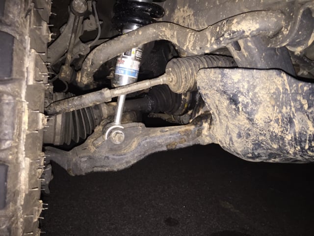

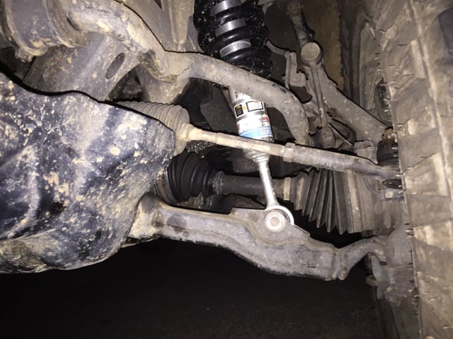

Post a few pics of your CV angles and such. We may be able to better assist. CV leaking is somewhat common because the angle is now positive rather than negative so the opposite side of the boot is getting more grease. New CV clips might do the trick.

Best I could do.

Those angles look typical. I would try the Zero Point first as it's the easiest and is quite possibly the culprit. Let us know how it turns out.
