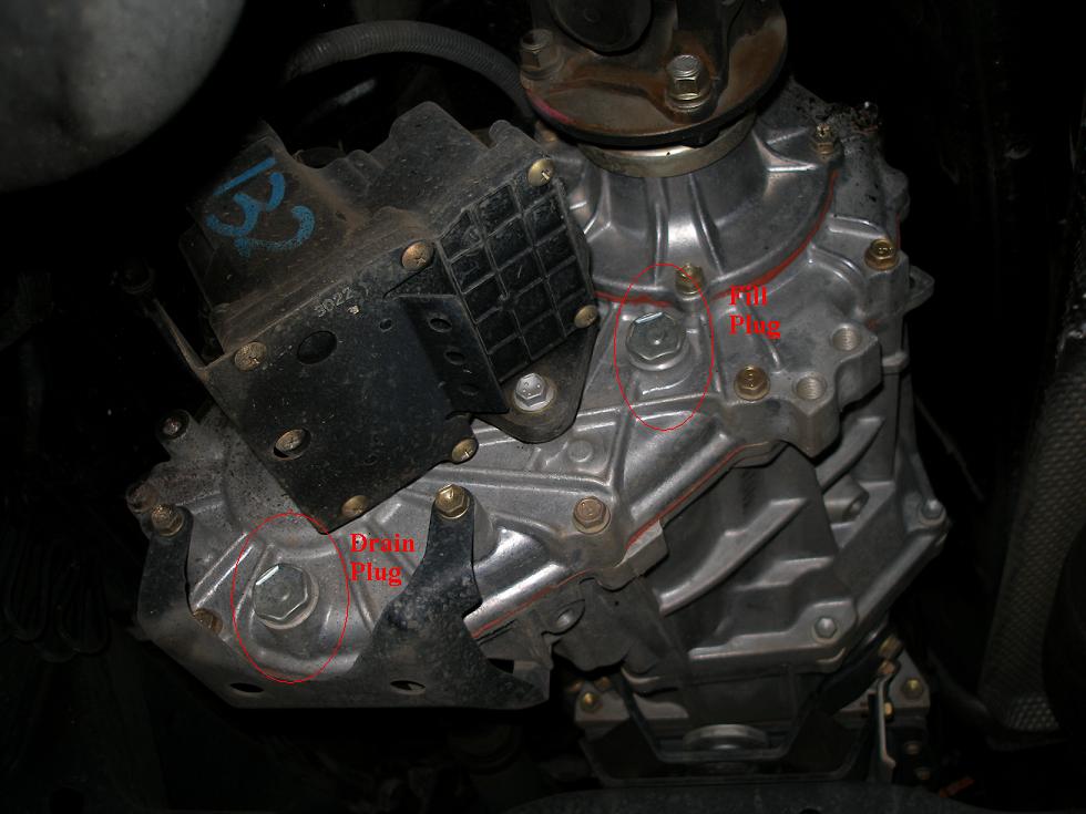

Hey guys, great thread! I recently changed out my rear diff fluid with synthetic (which was simple), and want to do the front diff & transfer case. However, I can't say I'm too sure where the drain & fill plugs are for an '03 V8 4x4. I'm pretty sure which plugs to drain & fill for the transfer case (in pic), but need the reassurance of someone who's done it. If someone can post a pic of the front diff plugs, & tell me if I'm correct on the transfer case, I'd be very appreciative!
You got it! Torque gently on the re-install. You're threading into aluminum.

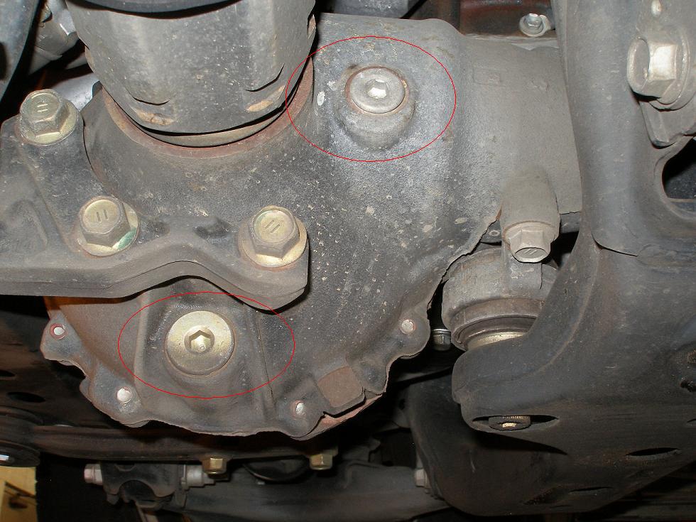

Alright. I finally got around to taking a pic of the front diff plugs. This is as it looks from the driver's side front tire.

You guys that have changed your front differential gear oil, which skid plate needs to be removed to get to the plugs or do they both need to be removed?
