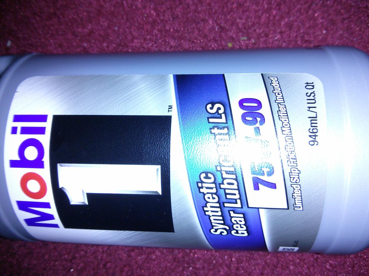

I'm doing the same thing as you are and just picked up my online order from the local advanced auto zone store. The clerk was new and seemed a bit confused about the whole process and brought be 3 different types of Mobile-1 synth gear oil. I directed him to the type in the below picture (75W-90 "Limited Slip Friction Modifier Included").
I believe that is for our 4WD models and hopefully I won't get the " rear diff. gear chattering" that some have reported when using Mobile-1 brand diff. oil.

Our trucks do not have a true limited slip rear diff so limited slip additive is neither req'd nor will it hurt anything if its there. Our "LSD" utilizes the brakes to provide additional traction to slipping wheels so no diff involvement.
