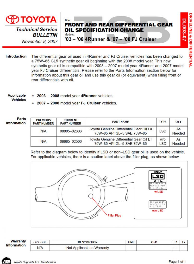

If you have a limited slip diff in a 4th Gen your rear diff should have a tag saying so above the fill plug, at least that's what I gather from the TSB.
