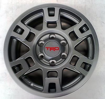

Tire size i'm not completely sure with since I plan on changing the rims to the 6 spoke 17 inch TRD rims
