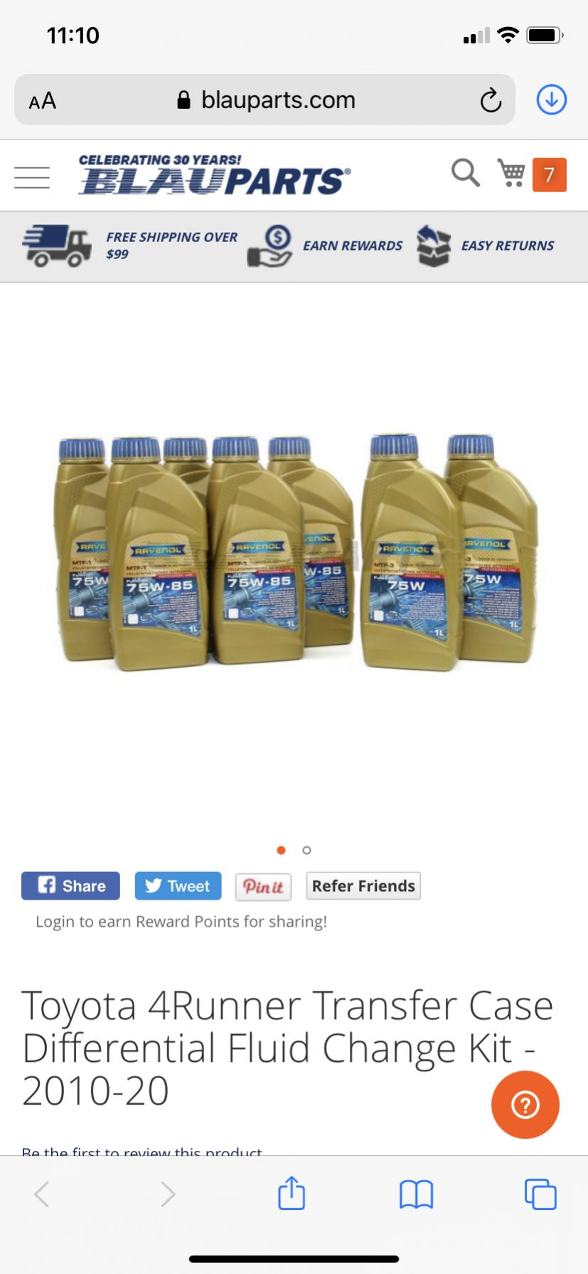

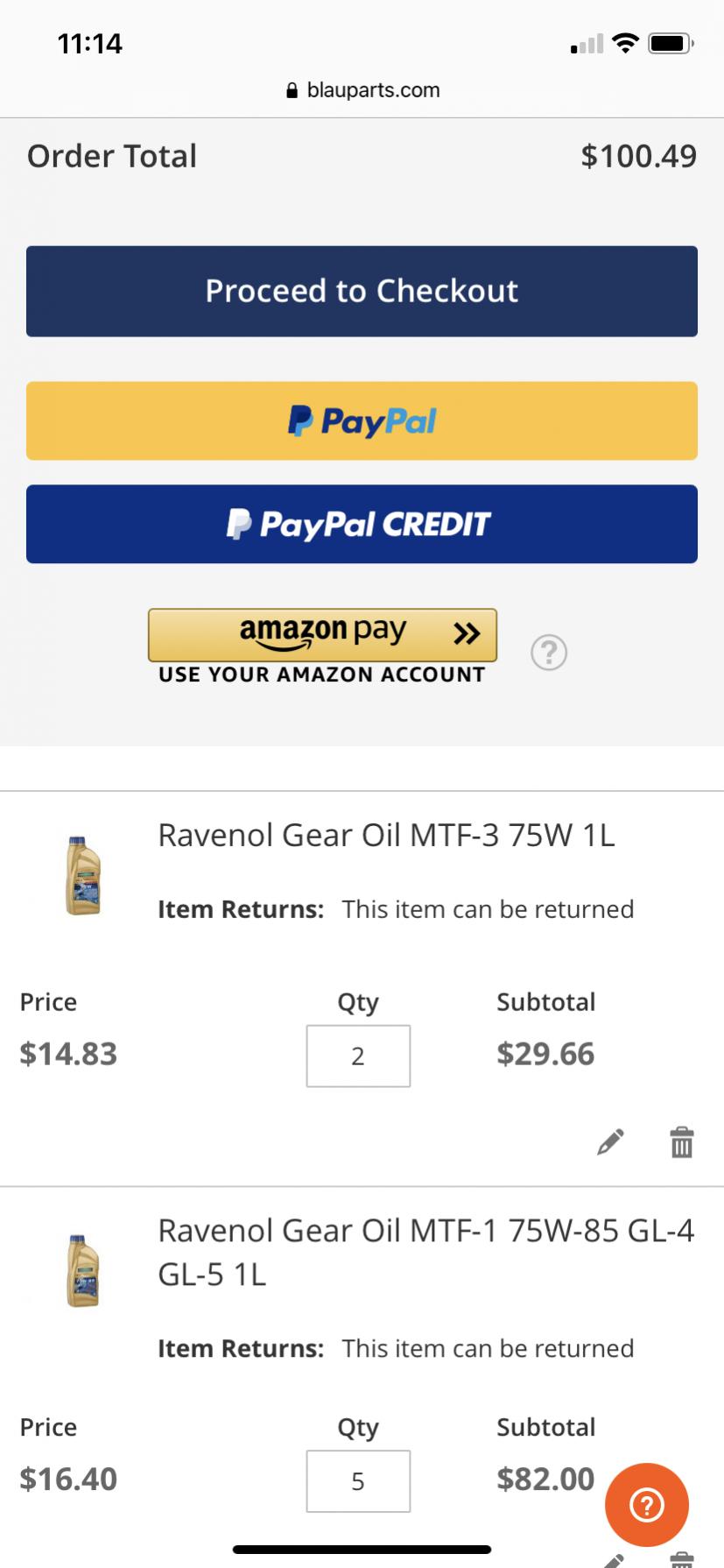

Looking at changing my fluid in my diffs and transfer case. I did it 30k ago all with mobile 1 75w-90 since that’s what most recommended. I like to go back and try a 75w in the transfer case and noticed Ravenol now sells a whole kit with 75w and 75w-85 for $100. Has anyone used this in your diffs and TC and how did you like it? Compared to Mobil 1 since I know a lot of people were using that for awhile

That's a very nicely priced alternative to the OEM 75w fluid for the transfer case! Nice find!
I have not used it yet... but I have looked into this before and planning to use Ravenol (J1C1003 SAE 75W) for transfer case.
As a side note: I have used Ravenol antifreeze (FL22 Coolant) in my wife's car- no issues.
I only use 75-90. That's all Toyota uses as well according to my buddy who is a mechanic at Toyota. I think he said they recently discontinued the 75-85.

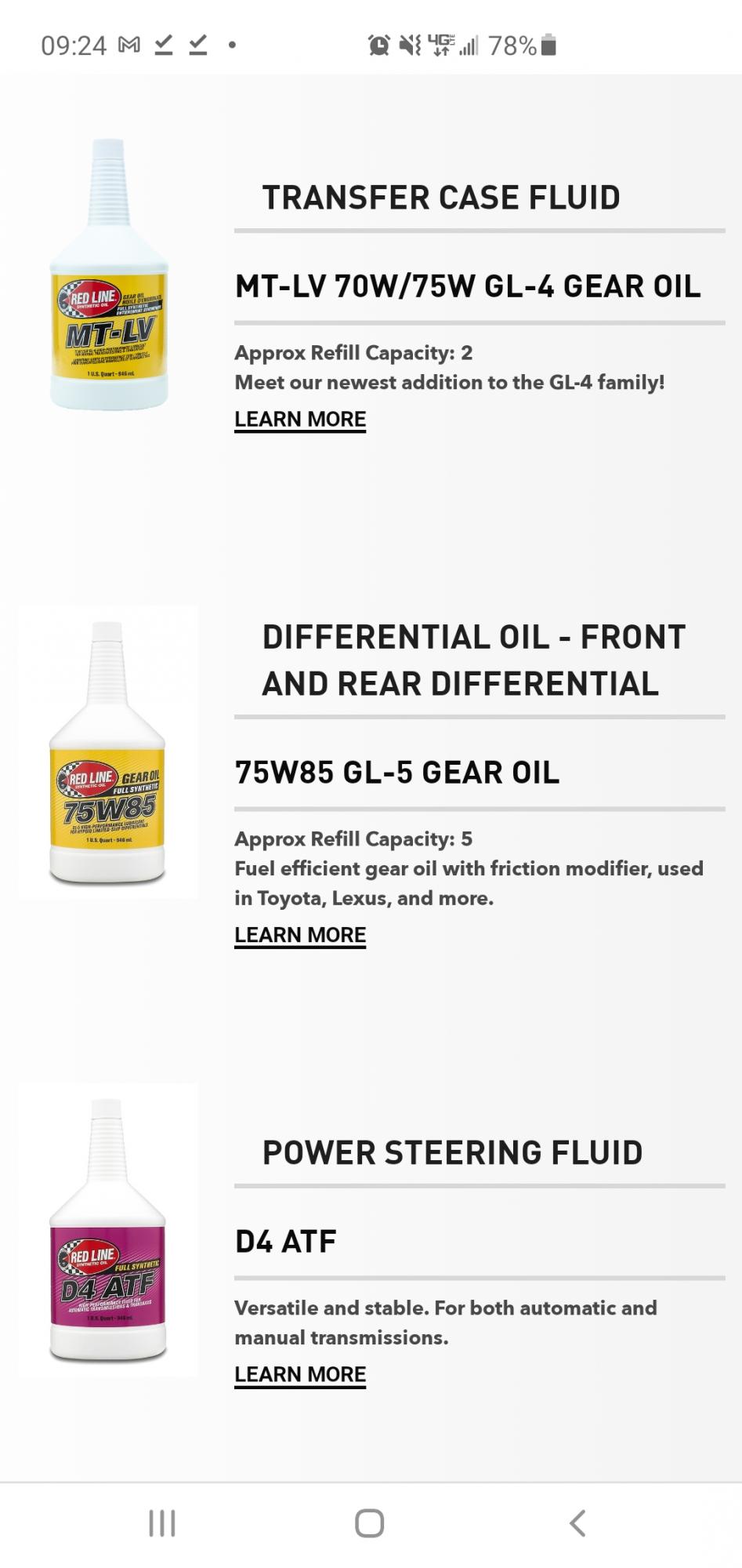

but dude.. the price was the reason why i went w/ redline. If i had to pay the same price for ravenol vs redline then i may as well get the redline stuff:
17.95 x 2 for transfer Redline MT-LV
17.50 x 5 (3 qts for rear, 2 quarts for front) of Redline 75w85

Does anyone have a link for the correct redline that meets specs for the diffs and tc?
Red Line Synthetic Oil
This for a 2015 4Runner
Red Line Synthetic Oil. MT-LV 70W/75W GL-4 Gear Oil
